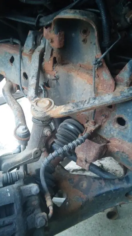

First things first locate your shock.
You have to remove the shock.

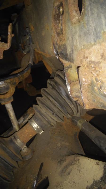

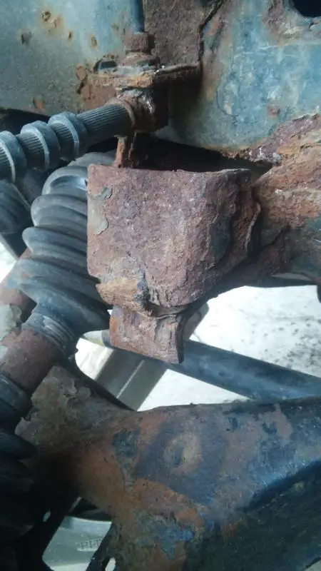

Next identify your bump stop.

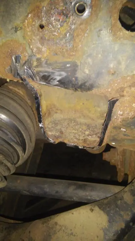

Then you must remove your bump stop and bracket.

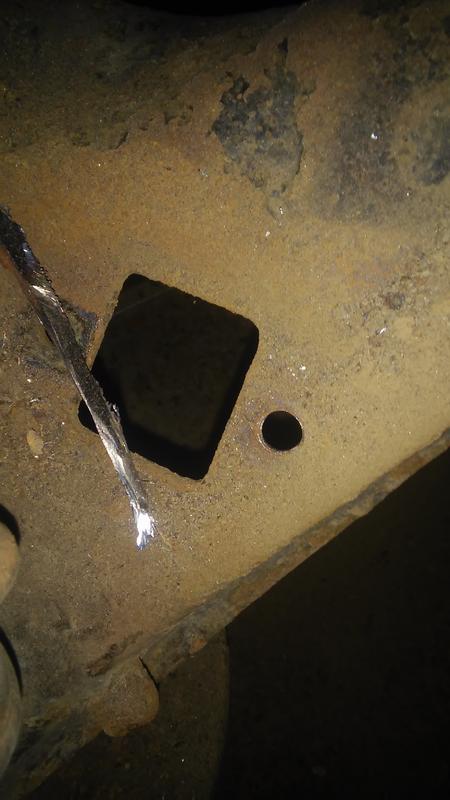

Then locate your shock mount hole in your lower control arm.
Drill your shock mount hole out to 1/2" or 9/16".
Install your shock mount bracket in the hole you just drilled out. DO NOT tighten till shock is mounted in the bracket!

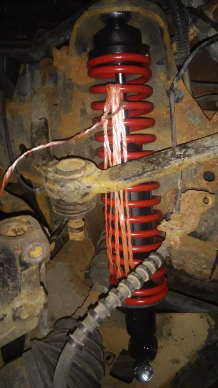

Compress your coil spring on your shock to make it easier to install. (I had to use the control arm and weight of truck to compress it because I didn't have the right tools lol) i used pull string to hold spring compressed while installing shocks.
Install your shock and tighten all your bolts at this time to complete the job.

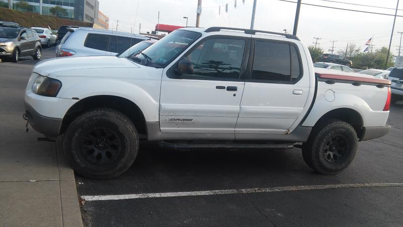

This is the truck sitting on a somewhat level parking lot.
P.S. no torsion twist here just body lift and shocks. :D
The front lower mount looks a little weak in my opinion. It's only one bolt for each lower bracket, correct? Because that lower mount has a very small spread across the surface of the control arm, I can see that mount eventually wanting to rip that 1/2" hole open, especially since it's right next to that big square hole. If you could have a couple of longer tabs welded on instead, I think you'd be better off. Just my $0.02.
I agree with mounty71, beef up lower mount, apart from that it looks an excellent methods of maintaining ride height.

Just go to Summit and get a t-bar kit and mount that shock the way the LCA is designed. No drilling required and the stress is spread out across both bolt holes.
Why reinvent the wheel here?

I think a t-bar is still under-kill for a coilover in this situation. The stock shock mounts weren't designed to support the weight of the vehicle. Plus he already drilled the arms, and there isn't much material separating the bolt holes and the square opening.
Don't worry guys and gals. We've already talked about it and I told him I'd weld the bracket onto the LCA along with adding gussets and welding a piece of flat steel to close the stock shock hole (square hole).

You can't put the coil over shocks in the same place as old ones because it won't clear the half shafts. So you have to do it the way I did for clearance.

I measured from top of my 285/75/16's to bottom of fender and have 7.5" with no torsion twist. Measurement was the same on both sides.
