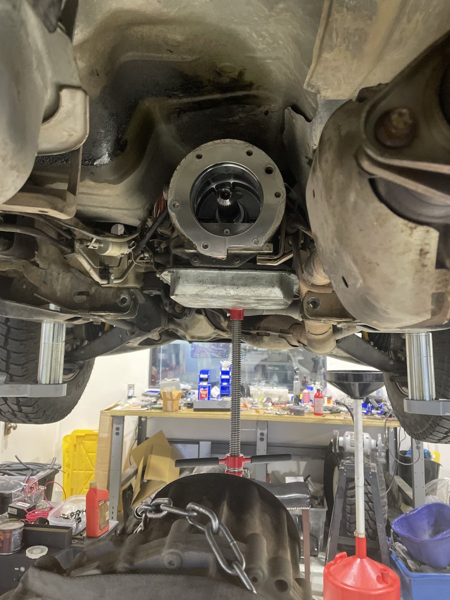

I've temporarily mounted the AOD pan onto the 4R, simply to avoid damaging my fancy aluminum deep pan. The next step was to remove the t-case, but I'm finding that the service manual (PDF) I've got seem to call for removing equipment that's not present on my 5.0L Mountaineer. It looks like my t-case could be removed without any further disassembly... certainly does not seem to require removing the exhaust or any kind of crossmember since it sits further behind the main transmission member.
I would remove the trans crossmember just so you can gain access to the top t case bolts
Otherwise you can get them through the floor access panel
The transmission mount is attached to the center exhaust hanger via one of the trans mount bolts
The awd t case has no wires or motors or anything just two driveshafts a breather tube

The ultimate goal is to remove the transmission right now because it needs to get to my friend's shop for rebuild. I was planning to remove the t-case just to make it easier to remove the transmission, but now I'm thinking that perhaps I just remove the entire assembly as a unit? The t-case can't weigh that much because it's currently, literally just hanging off the tailhousing of the 4R!

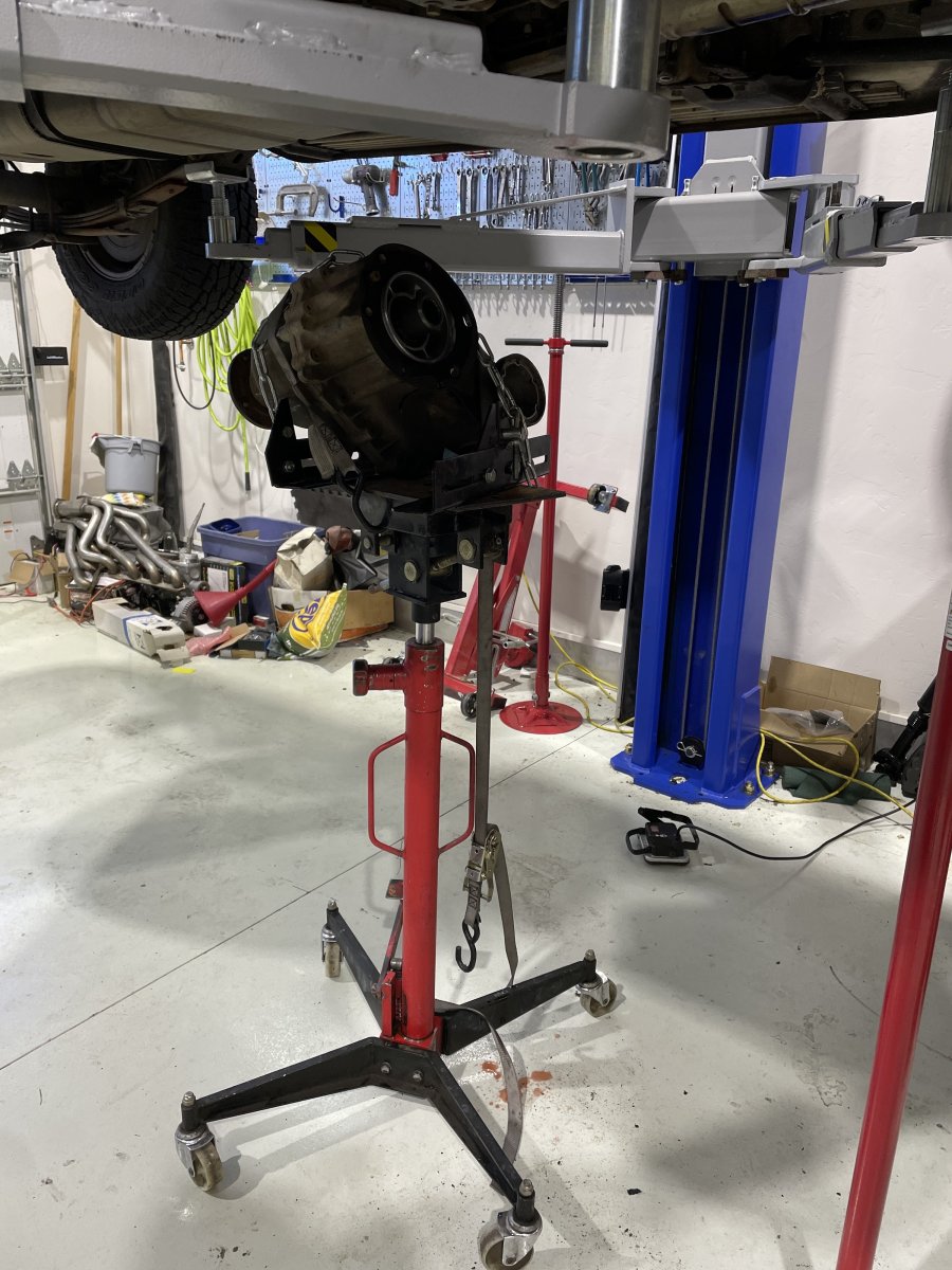

T-case is out!

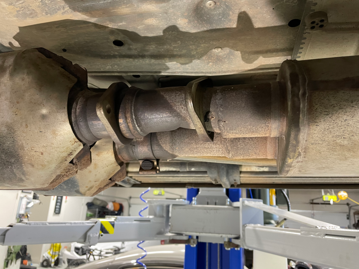

The exhaust is really jammed up in there... had to throw in the towel. It's totally loose, but it's fused to the muffler end pretty bad and even if it were all loose, not sure how to rotate it out of there LOL

You should just be removing the down pipes not the whole exhaust
If you have to cut bolts no harm no foul. You can order new gaskets online as well if you end up needing them

Thanks. Confirming that I'm trying to remove the downpipes, for sure. I've got all the sensors out of the downpipe and have removed the bolts at the exhaust manifolds as well. The passenger side manifold connecton is especially difficult and I have no idea how I'm going to reattach the exhaust to that again... that looks particularly tough.
Anyhow, the muffler ball flange connection to the downpipe seems to be where the exhaust is stuck right now. The other tube attachment looks like it uses a welded on Torca clamp and that is full loose as well. I've removed the nuts and bolts to the ball flange clamp. Maybe it needs the heat from a torch or something to loosen up?
Pry bar?
You can get the two manifold to downpipe bolts on the pass side by using 3/8” ratchet and extensions w wobbly working back around the primary cat for that pipe access is not terriblenonce you get the correct angle

I was still totally unable to remove the exhaust for some reason. I did manage to get the transmission out without removing it, however. It's at the shop for rebuild and spec'ing a Precision converter with billet lid, single Luk clutch with a stall between 2300-2800 RPM.
