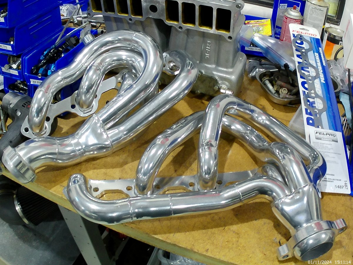

The headers arrived. They look good! In my case, the Felpro 1487 gasket is necessary to match the exhaust ports in the heads.
Have you considered the remflex? I have excellent luck sealing headers w the remflex ever since @Rick recommended them
