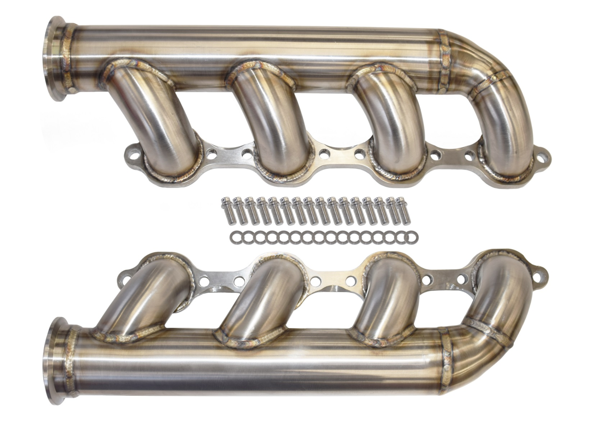

I wonder if these would fit (turbo headers)
No room to bend to get under the firewall. Might work on the passenger side, but not the driver's.
So, with slight modification that might work. would have to change the angle of the v-band connection a bit?
This type of "block" header isn't too hard to fabricate, flanges and v band clamps are easily and cheaply available from interwebs
Nothing slight about it, plus I don't see any improvement over the standard headers. The TMH/OBX headers are short tube collectors and are designed to add power and torque. Those just dump into a long tube like the oem. (look at the 98-up headers and you will see that I am talking about.
yes but they might also remove the factory bottleneck that is costing us power right from the go
This is an expensive game to play....buying headers just to see if they can fit.
I highly doubt that style header is viable, or someone would have made them already. There’s a reason the TM headers are so convoluted, and barely able to be wedged in there.
