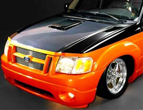

Hey Matt, are looking at that shaker hood for Black Magic? It would look good. Kind of pricey at $750 + install & paint. It could serve as cooling for the supercharger, but would not really add an horsepower. No ram air effect would be possible with our set up. It does look cool though!

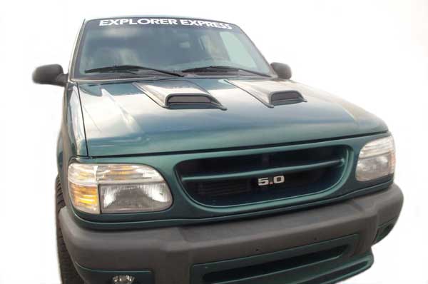

We do not have any specific hood upgrades for the 2002 Explorers. But we do carry the Lund Eclipse Hood Scoops. They actualy look pretty good when painted.

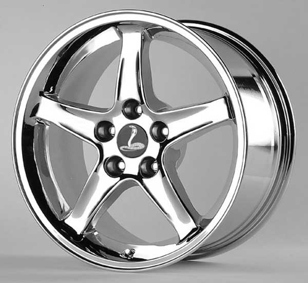

By the way, I will try to find out what kind of wheels my Mountaineer budy has. I think it would be hard to find 10" wide wheel with the correct back spacing. The problem is rubbing on the "inner fender/ frame" at the rear. We know the Cobra 18" X 9" will work with the 285/50-18 tires. The Cobra R replica wheels have a 5 15/16" back spacing.

So are you saying that it would work with the S/C? I just wanted to make sure since the lower portion is actually mounted to the motor.
Well Matt, that remains to be seen. I guess I meant that it is possible, but it would not be functional. It would have very little effect, it would be mostly visual. The blower going to be pretty close to the hood. We would have to take a good look at it. Take pictures and measure. It would definately have to be modified. Let's get the supercharger installed first and take it from there. I will be in touch soon.

hey john, will the cobra r in 18s rub at all with 255/55/18s?
