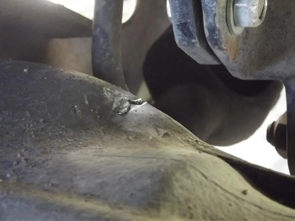

so heres a pic of why you dont buy a rough country lift.
weird thing is i have the bumpstops on and i havent bottumed out since lifting...

That bolt loose? I would think it should protrude through the locknut a few threads. bracket looks loose too.
Yup.. that drop bracket can do wonders to the Pig..
Ageman put a nice hole in the top of his on MLK weekend at truckhaven this year. That was his first run out. We threw some JBweld on top of it for now.. I think he sold the truck with the JBweld still on there.
And that bolt does look loose to me too.. Or too short... But I see space between the brackets that I wouldn't expect.
~Mark
ya it does look loose, but the place that the bracket is bolted to is like rounded and not sharp edges so the angle and how close up of a pic it is makes it look like theres a gap, but just to be safe before i take her out again next weekend i'll try and give the nut a turn.
~Mark
i think i saw his thread awhile back. i'm hoping to avoid a big hole in mine but then again that might be enough to make me actually go through with a sas.

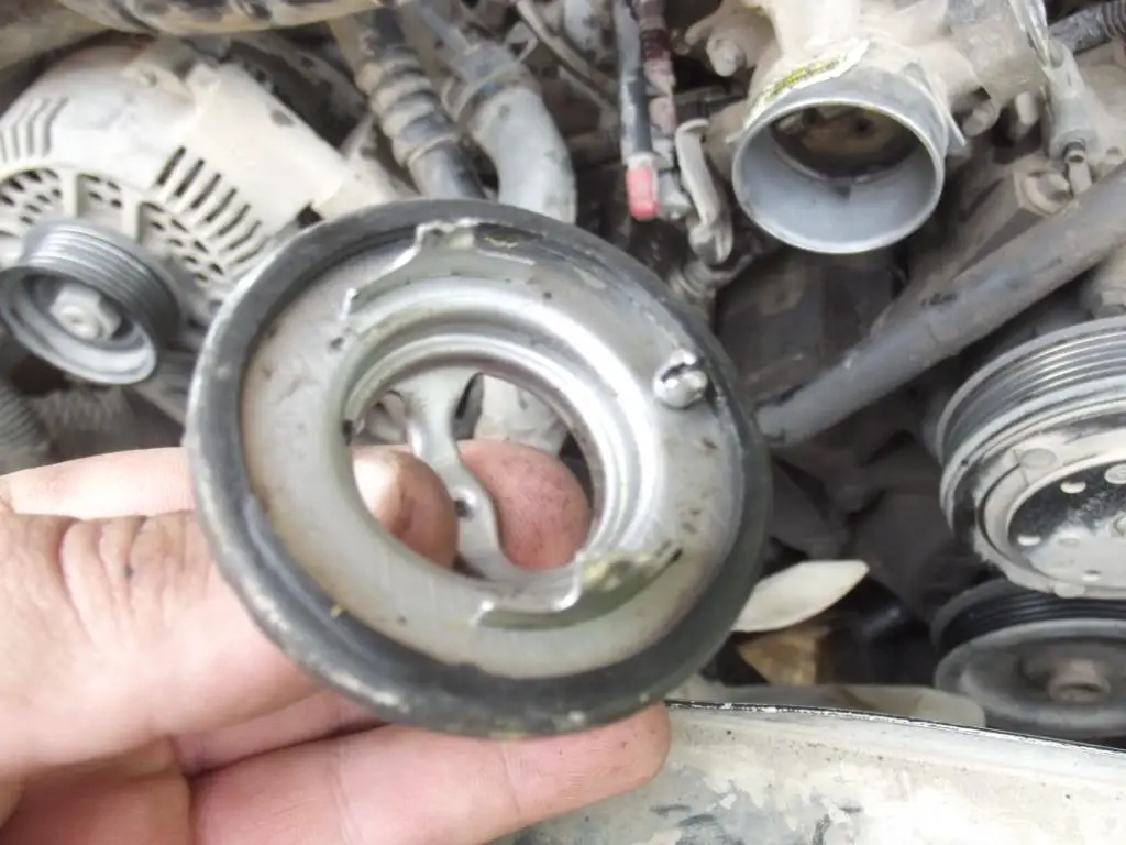

ran into a bit of a problem. i got the thermostat out. well half of it anyways, and thats the problem. the t-stat broke in half right below where the gasket goes and i cant find the bottum half. i tried to fish around inside where all the coolant is but i couldnt find it. is there going to be a problem? or will it just rattle around in there and not mess with anything?
