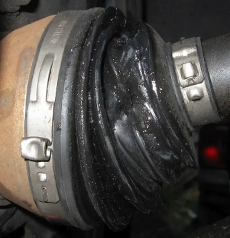

I can't say on other years, but my 03 Trac didn't have the wheel seals originally. It should be easy to tell a rubber boot from the plastic ones the early trakmotive extended axles used, the stuff was thin plastic, didn't feel like silicone or nitrile rubber. I ended up swapping to manual hubs after several sets of the extended ones failed, and my driveshaft boot split. They don't make them for the pvh style hubs, so I haven't looked into them anymore.That are good news, hoping the best for the new boot design.
Had two sets of the Tracmotives and was not lucky with the boots,
Rockauto discription
"Premium Thermoplastic Elastomer (TPE) boots are stronger and more resistant to off-road damage" (HaHaHa)
So i gave GSP a chance,
"GSP axles use only premium grade neoprene boots that ensure robust abrasion and extreme temperature resistance, preserving boot integrity in even the most extreme conditions"
It is not really rubber, it feels like soft plastic, the material feels very thin too.
Became wrinkles after installing, no chance to avoid this (both sides).
First fails at the outer side, half year later the diff side fails.
Another issue are the dust seals on the wheel side, they crack too (Trakmotive and GSP use the same).
I use SKF 25013 , it is a two piece design, they never fail until now.
