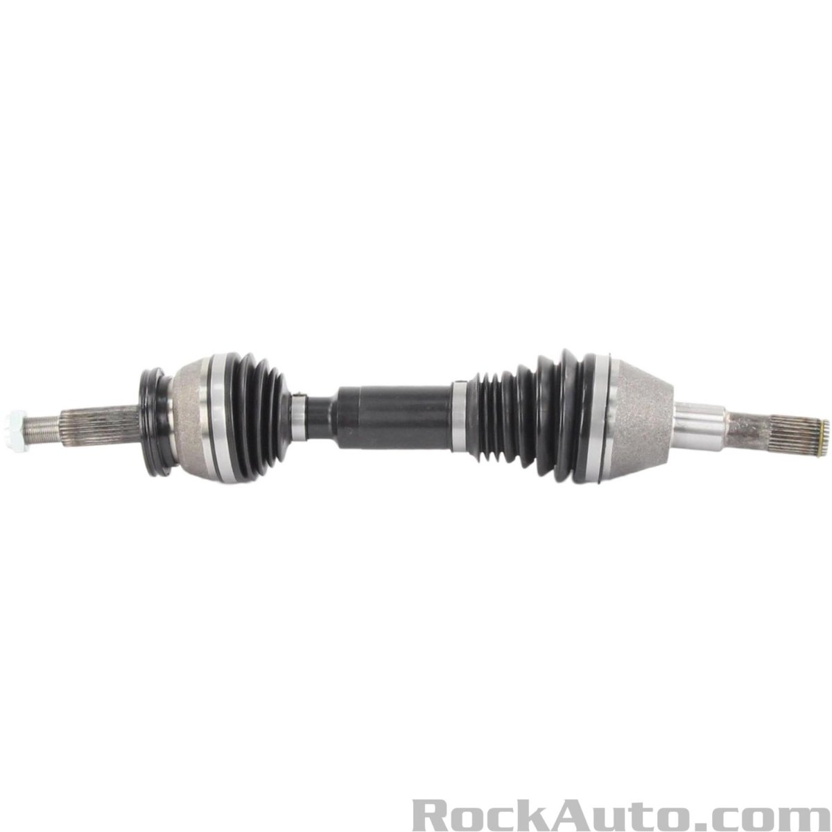

I have a 2000 Explorer XLT that I have done about a 1.5-2 inch lift on using shackles in the rear and torsion twist in the front with keys. Some time ago, replaced the CV axles, as they were making some noise and vibration. I decided to go with the Trakmotive Extended Travel Axles, as they were the only ones listed as working with a lift. I went with the FD-8021XTT and FD-8004XTT for left and right respetively.
Upon installing them in the truck, I noticed that I could hear what sounded like rubber squeaking at parking lot speeds coming from the front end. The noise would go away above about 10mph, but I thought that was odd. Lo and behold a few months later, my new axles started clicking and crunching just from regular street use. Upon looking underneath, I found that the outer boots on both sides were basically shredded and grease was everywhere. Looking at the axles closer, it looks like the boots were all bunched up and just wore through themselves. You can even see in the attached picture that I took from Rock Auto how the outer boots look like they are bunched together and would be rubbing on itself.
I contacted Trakmotive, and they said that I should return the vehicle to stock height and exchange them with RockAuto where I bought them. I thought it was wierd that they told me to put it back to stock height when they are advertised for lifted vehicles. Anyways, I didn't want to wait weeks for the return and be without my rig, so I went to O'rly in town and bought a set of Precision OEM axles. I've put a ton of miles on the Precision axles, and have done hundreds of miles off road, and there is no hint of failure.
So that long story leads up to my question... Could I have possibly done something wrong installing the axles? I feel like with the way both of the front axles failed in the same way at the same time, that another set of the same Trakmotive axles are just going to fail again. I asked Trakmotive support this same question and they pretty much blew me off. I searched the forum, and everybody seems happy with their Trakmotive axles. So it makes no sense why both of my axles blew up, and I don't wanna waste my time putting another new set back in only to have them do it again. I'm probably just going to keep runing the Precision ones anyways. But sucks having $400 worth of fancy long travel axles sitting around that I can't use, and will cost even more to ship back for replacement. Thanks in advance.

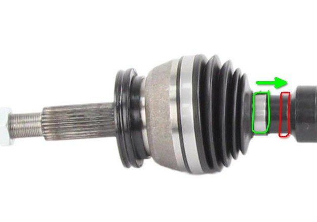

Crappy aftermarket cv axles will have boots that the ribs rub each other and the material they use is so cheap that the boots eat themselves very quickly…the fix can be as simple as removing a clamp and stretching the boot out a bit, then re clamp
Or just avoid the crappy aftermarket parts with boots like this. Factory cv axle boots can rub the ribs together for 200k miles and never wear down… it’s the quality of the boot material trackmotive used

I had another thought about these too... What if you just cut off the clamp, and moved the boot out a little bit? I feel like it might rub on itself much less. I think I might give it a try, since they have the warranty, and I really have nothing to lose. They're just sitting on a shelf at this point anyways.

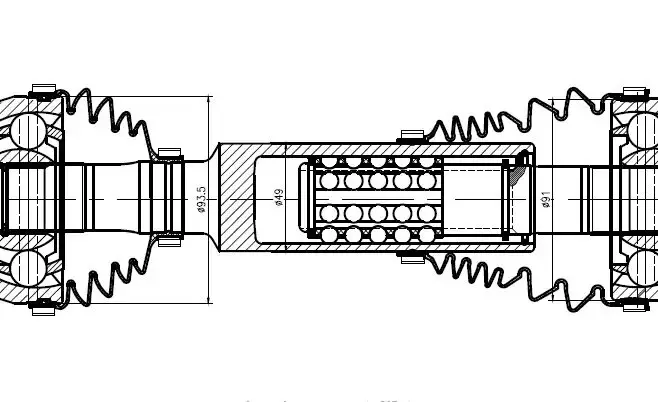

Normal/Original CV's have an rzeppa joint on the wheel end and a tripod joint on the inner end.
The rzeppa can do higher angles than the tripod, but the tripod can deal with the change in length of the axle during suspension travel.
The extended travels are rzeppa on both ends so they can do higher angles. They add that sliding element in the middle of the axle to deal with the change in length (a capability they lose when they drop the tripod end).
It sounds like the originals can work with a lifted front, but I wonder if there are [efficiency|reliability|predictability|whatever] gains by not operating the tripod joints near their angle limit. Maybe I'll measure the angle when it's not -10f outside.
