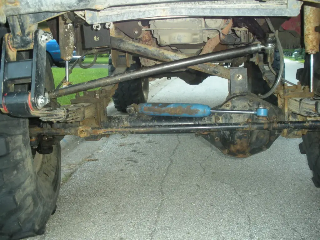

Heres my Setup. I just threw everything together because I had to move it out of the driveway and I'm waiting on a full spool.
Your panhard bar is on the opposite side. Remove it.
Why did you choose for the panhard to be opposite of the steering?
The man that helped with the welding on my truck did the panhard like that. Not sure why he did, but I didn't question since he has a Chevy on rockwells that he bulit. Whats the problem with that?
Your panhard is on the wrong side. When the front end goes up, the axle shifts to your driver's side and the tires start to go towards the passenger side.
Have you tried running it without that backwards panhard?
Yeah I did with my old steering(it drove alot better without it), havent got a chance to run it without the backassward panhard and new steering yet. Thanks I will give that a chance tonight.
Report back. :cool:
Holy crap get that panhard off of there before it kills a busload of nuns. :eek:
The tracbar (panhard) has to run from the same side as the draglink. Having it run from the opposite side has your front end set up like a pair of scissors. When you hit a dip on the street, the panhard pulls the front axle passenger as the steering pulls driver... i bet the bumpsteer is... "holy ****" for lack of a better term. The fact that you can even keep it on the street says you're a pretty good driver.
The tracbar needs to mimic the draglink. Same angle, and both need to be pretty close to the same length. Please please pretty please dont drive this thing on the street anymore until this issue is resolved.

Well I took the trac bar off and went for a drive to get some ice cream. It doesn't yank/pull anymore when I hit a pothole. Overall, it drives smoother and straight for once. I still have some swaying motion, so I'm thinking I might just lower it 2 inch, new tie rods and relocate the panhard. Has anyone done custom sway links for their SAS explorer?

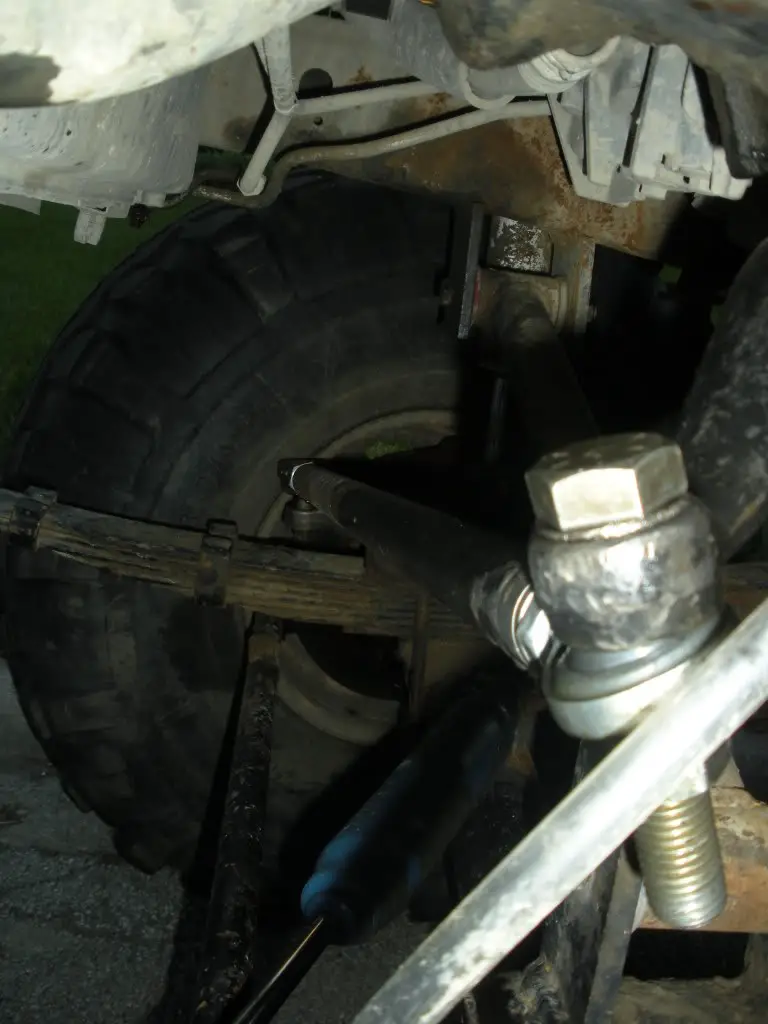

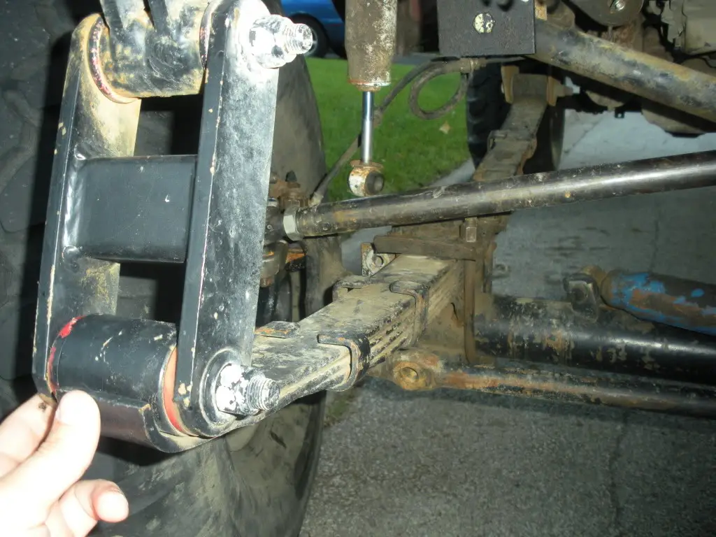

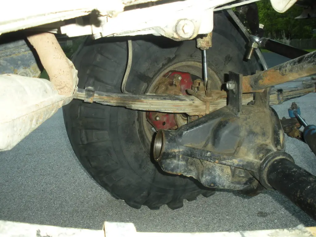

Here are some old pictureshttp://i861.photobucket.com/albums/ab172/Davebot123/DSCN0462.jpg
http://i861.photobucket.com/albums/ab172/Davebot123/Truck/DSCN0463.jpg
http://i861.photobucket.com/albums/ab172/Davebot123/Truck/DSCN0436.jpg

Youre majority of the problems are this.
1. You need to report youre castor angle
2. Trac bar is as backwards as possiable.
3. you have no sway bar. Yes its possiable to run one. I have one on mine. it stopped the side to side swaying. I used stock bar in stock location with JKS jeep cherokee end links. Its like clock work when its together.
4. the shock on pass side was not hooked up. Maybe you just took it off to try it.
Long story short if you put a sway bar on it it will kelp 2000% bud. ppl on here say they drive them without a sway bar but i couldnt drive mine without.
