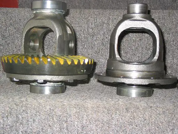

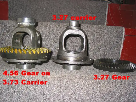

The Dana-Spicer model 35 equipped on the 1991-1994 explorers
does not have any carrier breaks. I have compared the 3.27 carrier with my new 3.73 carrer, they are identical. The gears are infact
'thick'.
Pretty cool huh? Ill get a picture of the two carriers side by side once i get everything buttoned up.
