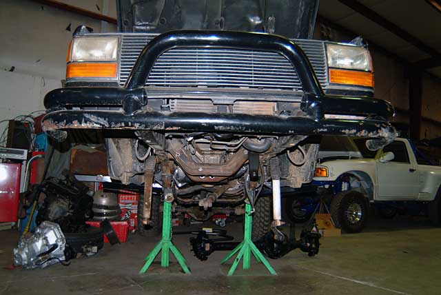

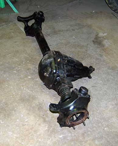

Photos from the shop:
Looking Nice!
Sure Rick, steal my fire :)
Did you see the complete front assembly sitting in the back. I left the tires on and everything.
oh yeah, when are you going to have the video of them rolling the desert racer?
You know that was the best feeling I ever had, when my frontend looked just like that picture :D I also felt great when it was all back together too but TTB out = relief ;)

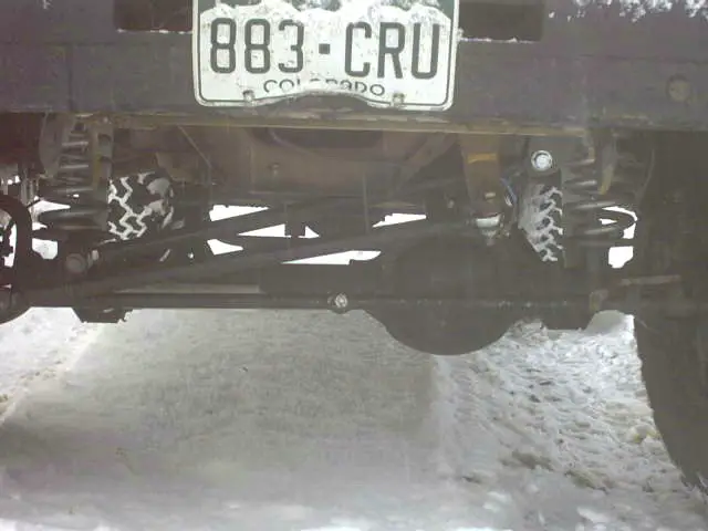

Hammer I did do a write up but I deleted it. I do have a bunch of pictures though :D I still have yet to get it out and wheel it but I am planning on Moab in Feb. Here is what mine looked like after the conversion :) Enough about me though ;)
I also moved my axle fwd 3". I could even stuff 37s not and still not hit the firewall. I cut my engine cross member like they did to Hammer's for added clearance.
