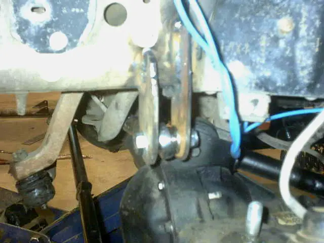

Pepper had just started working on the track bar mount when I left yesterday.

Trac bar bracket pic= shows me just how much i cannot weld. :p
