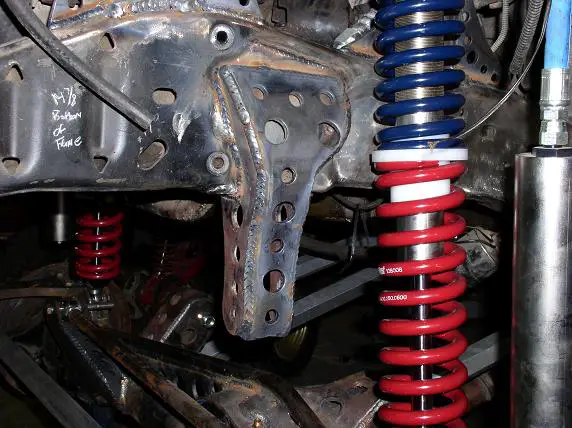

Updates... All of the axle brackets are finished and have been welded to the axle housing. Aluminum links have been cut to size and the front bumper is finished.

Did they do anything special when welding the brackets to the cast center sectoin? I have a spring pad thet needs to be welded to a cast centersection :D
Yes, they preheat the cast material before welding. They welded to my center section and I haven't had a problem in 5 years... knock wood ;) They also welded to my steering knuckle which many say is a no-no.

www.lincolnelectric.com/knowledge/articles/content/castironpreheat.as
this might help
If it won't take you there between 500-1200 F but never over 1400 deg. F and short welds with no cooling at all.

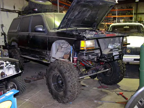

Update:
Matt, Pepper and Myself put on a Marathon last night.
Bottom line is, the EX is now on all fours again :eek:
Pepper welded for 2 solid hours, Matt and I finished some guseting, finished putting the front 60 back together and got the arms ready for install. We then put that heavy sob under there. Hung the coil overs and installed the tires. NO JACK STANDS! We left at 10PM.
Much thanks to Matt and Pepper for staying late after working all day.

Dropped the gas tank tonight. Doesnt smell too bad but two and a half year old fuel is not something I want to run in my motor. I am going to have it cleaned and reinstall it asap.
Installed the rear drive shaft and set the pinion angle.
Pepper welded some more and only has a little more to go.
I removed the headers and steering box so he could get behind my shock hoops and weld. Headers are not so hard to do when your inner fender wells have been completley removed :confused:
