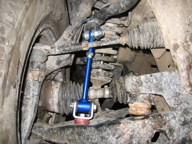

I think Gman meant that the straps look short. Like they limit the amount of droop you get even more than the sway bar would. How much downward travel do you get from ride height?
Well, close to what I'm getting at.
I was actually wondering about how much more travel was gained. Without the swaybar, the travel can only go so far before the CV axle gets messed up. How far before that happens I am not sure. I need a set of limit straps installed, and am trying to figure out the proper length for mine.
3 inches down and 3 inches or so up. The strap length really doesn't matter. How the strap is mounted determines the limit to the travel. I still see full travel minus about 1/2 inch or so even though the straps are hooked . The sway bar doesn't limit the travel in the IFS so long as both wheel move the same direction, both up or both down. It is when the suspension tries to move independently, say one side up and the other down, that sway bars will limit the amount of articulation
By unhooking the sway bar you are allow each wheel to travel independently without the swaybar trying to force the opposite side into the same position.
So gains in travel= 0
Gains in ride quality and articulation= :thumbsup:

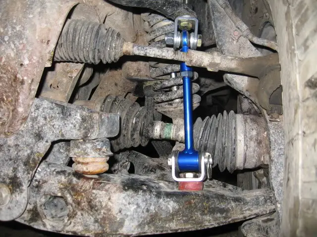

I think the base of your sway bar links should be rotated 90 degrees, so the pin is aligned fore-and-aft. That would allow the link to rotate around the pin as your suspension cycles, allowing the entire bushing to take the load. The way it sits now, only the ends of the bushings are seeing the load.
Those end links look perfect for what I need. Cant stand the bobble head action I get from having the front sway bar attached, while wheeling. Some advice on limit strap placement/installation would be helpful info for all. Looks like a set is needed for the Black Hole as well! :)
Scott, the top of the disconnect is a heim joint allowing for the cycling of the suspension.
Clearances are an issue with the newer trucks as the cv's and tierods will interfere if you realign things. So far, I have 3200ish miles on the prototypes with great results :).
