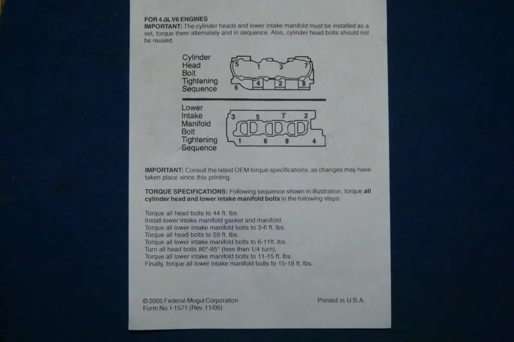

well since this is related to, well all of this, Do you guys follow the haynes/fel pro torque procedure where you torque the heads in sequence with the LIM or do you all just torque the heads up and then do the intake like the heads were never off? I remember reading a thread where someone was saying you dont have to torque them in sequence and had a ford master tech as his reference

Torque in sequence.
If the heads are going back on, torque heads, and lower intake bit by bit in sequence. Manual says to, and its always better to be safe.
If your not pulling heads, and only lower intake, no choice. Have to just do lower intake using sequence of bolt tightening suggested by felpro (If using felpro gasket)

Thats the way I have always done it, and never had a problem. I was just curious because it would be a hell of a lot easier if you could do them seperate cause I always feel like im racing the rtv on the intake gasket. Last time my torque wrench batteries died and I had to run inside and I couldnt find any. thankfully i had the good ol faithful clicker lyin around

Dang give me a min to post hahah
Anything else?? Hahahah :):););)
I love that lil sheet. Beats trying to read out of haynes cause then you knock the book over and it closes. When I was pulling my heads I wanted the sequence to go in reverse and my new gaskets werent here yet, yeah it was on the floor under the table and somehow I knew it was there
