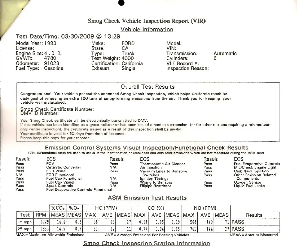

...with 291,000 miles on it, but it did, and I didn't even have to throw any parts at it either.
...Congrats...You must have passed the EVAP test also...:biggthump
I was super worried about EVAP specifically....but I guess it did ok.
*edit - After looking at what they do to test Evap, I shouldn't have been to worried. I didn't realize that its basically a leakdown test on the tank / filler tubing / evap lines....
Heres the form if anyones interested.
....That is pretty clean for a stock motor with 291,000 miles on it...:biggthump
Man I wish mine would pass that well! I just barley pass on the low speed No ppm part of the test. On that part I am always just a few points below the top end. All the rest I am not even close so that is always my sweat it out part. Like you I also have over 200,000 miles on it now!
Just got to love the Calif smog test. I agree with the why I just do not agree with calif's way of getting there and shafting people to do it!
291,000 and it hasn't failed a smog yet....I hope its the same way 2 years from now....
I was afraid for it....but it passed, and pretty well.
