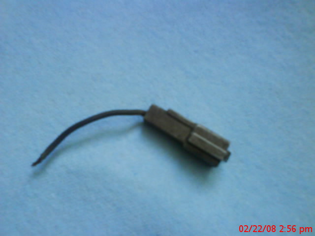

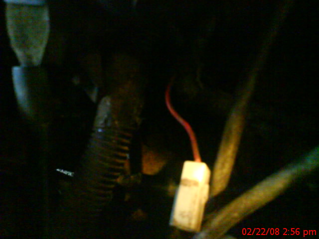

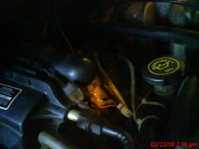

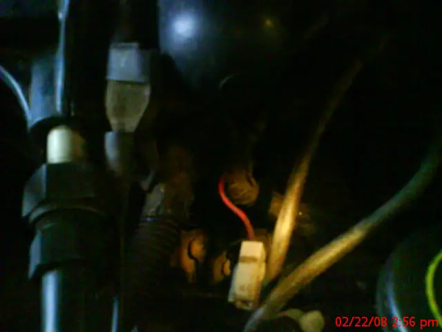

i think this may have been broken when i changed my plugs.

the red wire is the one that is was attatched to
That looks like the plug on the coil pack.. If I remember correctly it goes to little metal thing that is actually on the coil pack bracket.. I think its called a "condensor".. and I think is actually a capacitor type thing..
~Mark
~Mark
Yup
Or "noise suppressor"

the wire/ plug you broke is for your coil pack condensor, you need to repair it, although I do not believe it would cause a no spark condition
