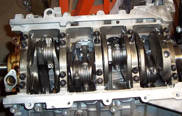

The rotating assembly is finally installed and I still can manually rotate the crankshaft.

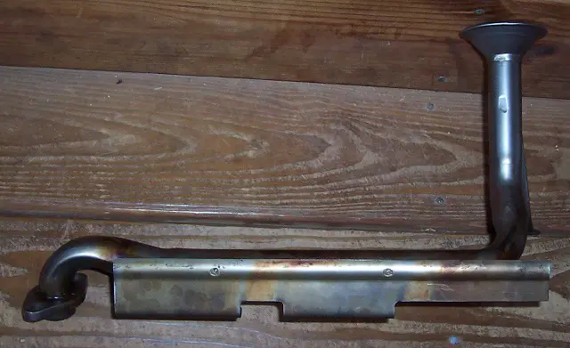

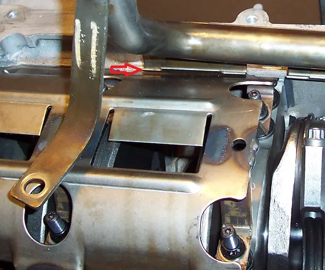

I've resumed work on the windage tray and the oil pickup tube. I found out from Tasca Parts that the hexagon spacer is M8-1.25x19 and the P/N is N806180S2 but they didn't have one in stock. The M8-1.25x16 bolt that fastens the oil pickup tube to the hexagon spacer has been discontinued. I found a M8-1.25x20 hex coupler (links two threaded rods together) online for $3.84 but the shipping was $11.00 so I made a trip to my local Ford dealer and ordered the part for $14.59. It should be here tomorrow. I purchased 2 M6-1.0x30 bolts at my local discount auto parts store but they are too long (specified is 27.5mm) bottom out and I can't shorten them because they are not fully threaded. I'll pick up some M6-1.0x25 tomorrow if I can find full threaded ones. In the meantime I'm using M10 nuts as spacers under the bolt heads. The aft (third) blade on the oil pickup tube interferes with the windage tray.

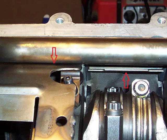

The aft blade is also bent which compounds the problem.
Straightening the blade with a large adjustable open end wrench made a negligible improvement. When the pan is installed it is resting on the oil pickup tube.
Since the aft blade overlaps the windage tray I've decided to just remove enough of the blade to eliminate any interference.
I picked up the hex spacer this morning. Turns out it is 37.5 mm long instead of the 19 mm I was told by Tasca. I should have realized that since the top bolt has a 16 mm thread length. I filed the edge smooth after cutting off the aft blade of the oil pickup tube.
I did a test fit and there is inadequate clearance between the pickup tube bottom and the pan. I'll have to determine how much to shorten the spacer. The 6-1.0x25 flange bolts I purchased this morning work fine at the oil pump end of the pickup tube.
With the spacer in place there is about .025 inches between the lip of the oil pan and the mounting block face. The oil pan gasket I purchased has metal inserts to prevent collapsing the gasket.
The gasket metal inserts are .125 inches thick resulting in a gap of only .100 inches between the pickup tube screen and the bottom of the pan. So I'm going to shorten the hex spacer .250 inches which will result in a total gap of .350 inches.

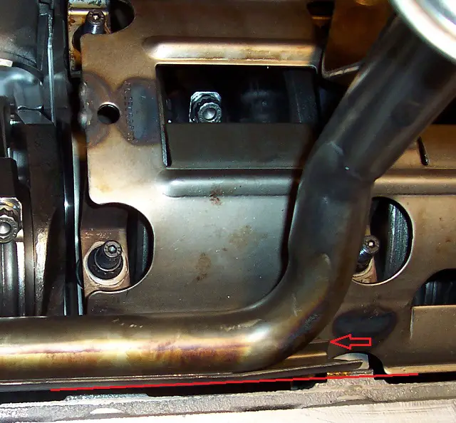

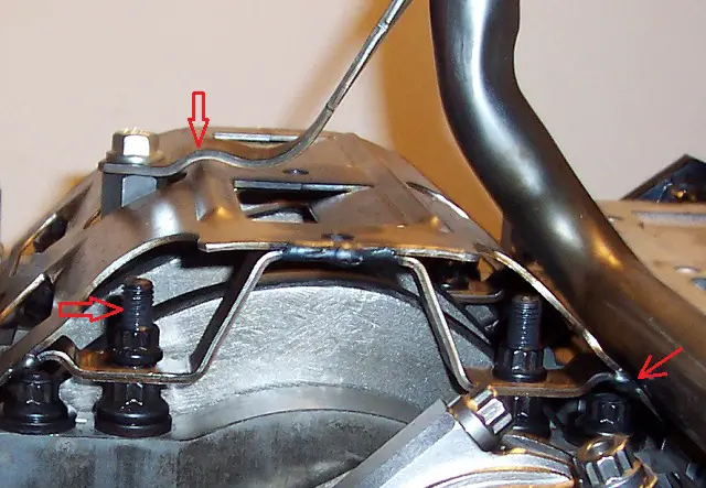

After the spacer was shortened the oil pickup tube support bar rested on the windage tray ridge so I bent the support bar to conform to the shape of the windage tray.
Another problem is the excess length of the studs. I had to shorten the 16 mm long spacer bolt to keep it from bottoming against the stud bolt. The arrow on the right above shows that the tube is resting against the windage tray. The only way to lower the tube is to shift the tube outward. However, to do that I had to remove more of the aft blade on the tube and bend the middle blade inward since it was against the inside of the block.
Now there is .240 inch clearance between the pickup tube screen and the bottom of the pan. With the pan gasket in place the clearance will increase to .365 inch.

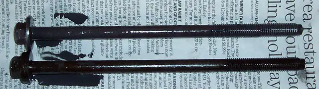

I still haven't torqued down my head bolts because of some issues. I didn't purchase the ARP head studs/nuts because they are expensive and I was afraid I would not be able to remove/install the heads with the engine in the vehicle because the engine is a tight fit. One of the FelPro head bolts I purchased is shown below - the one on top. I was disappointed that it does not have the integral washer that the OEM bolt has - the one on the bottom.
The useable length of the FelPro bolt is about .020 inches less than the OEM bolt and the threaded length is at least .250 inch longer. Since I was told only .006 to .008 inches was removed from the block deck and the head face for a max total of .016 inches there should not be a problem. However, 4 of the 5 outboard bolts on each head are binding before the bolt face contacts the mating surface of the head. This would result in inaccurate torque readings if the bolts were tightened. I used a wire to check the depth of the hole and determined the bolts were not bottoming out. Since the threaded length of the FelPro bolts is significantly longer than stock then that can't be the cause. The machine shop was supposed the chase the threads after tanking and milling the block but that may not have happened on all of the outboard holes. Or, more may have been milled off the heads and block then I was told. Another possibility is that the FelPro head gaskets are thinner than stock. If either is the case then the compression ratio will be greater than I planned and its a good thing there are valve reliefs in the pistons. Anyway, I decided to prevent the bolt faces from galling the softer aluminum mating surface by purchasing and installing a grade 8, .060 inch thick, 7/16 inch dia. washer on each bolt.

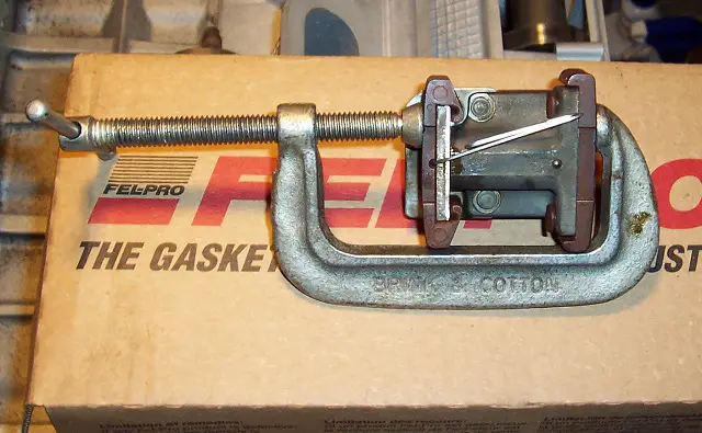

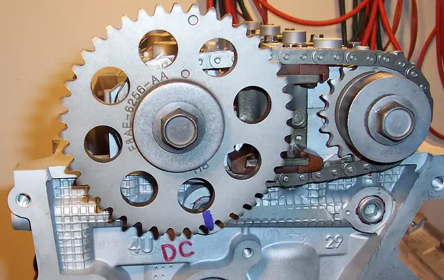

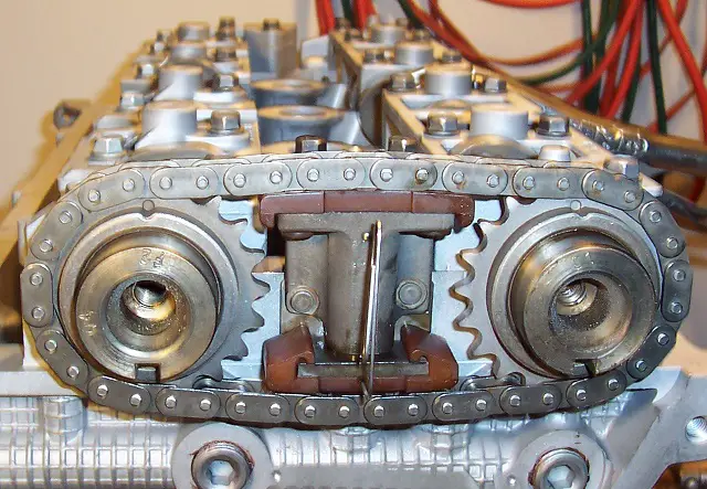

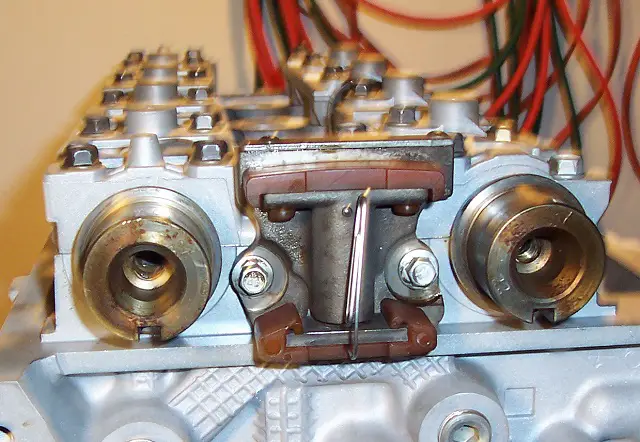

Continuing with the heads I removed the cam sprockets retaining bolts which had not been tightened by the head machine shop. Then I used a C clamp to compress the passenger side cam chain tensioner.
When compressed far enough the hole in the tensioner aligns with one in the backing plate and a large paper clip can be installed to hold it in position. Then I installed it on the head. I aligned the camshafts so the notches were below the camshaft axes and perpendicular to the head surface that mates with the valve covers. The chains have very little slack so it is necessary to get the sprockets spaced correctly in the chain before installing the assembly.
Then I just pulled out the paper clip and the chain was tensioned. In my opinion Ford incorrectly designed the passenger side tensioner. It can only be mounted with the tensioner piston protruding downward which is the traction side of the chain since the large cam drive sprocket mounts on the outboard/exhaust camshaft. The movable section of the chain tensioner should always be on the slack side where there is less chain tension. That way camshaft timing is maintained when engine speed is constant or accelerating. The shop manual states that the bolts shown below should be torqued to 30 lb-ft and then another 90 degrees.

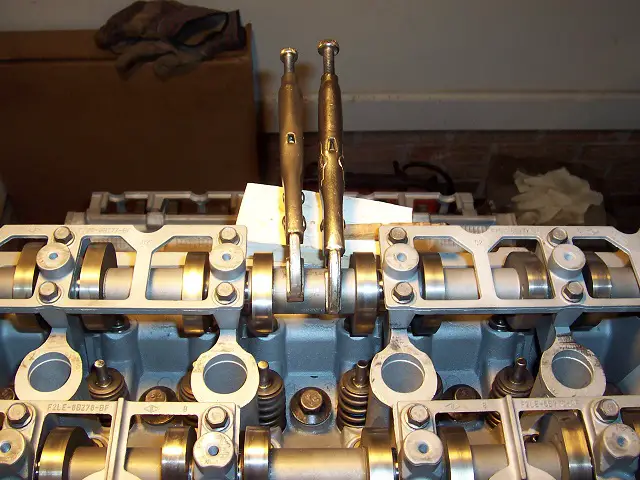

The mark on the large sprocket indicates where the keyway on the crankshaft points when piston 1 is at TDC. Since I don't have the special tool that clamps the cams I used two locking pliers and a block of wood to keep them from damaging the head surface that mates with the valve cover.
The locking pliers began to slip on the cam before I could achieve the 90 degrees but the torque exceeded 80 lb-ft. Since the sprockets are all keyed I decided that was adequate.
The driver side tensioner is designed correctly with the piston extending to the slack side of the chain since the drive sprocket is on the outboard/exhaust cam.

MMR makes a tensioner that applies pressure the correct way..this is a issue for the new 5.0 motors also..

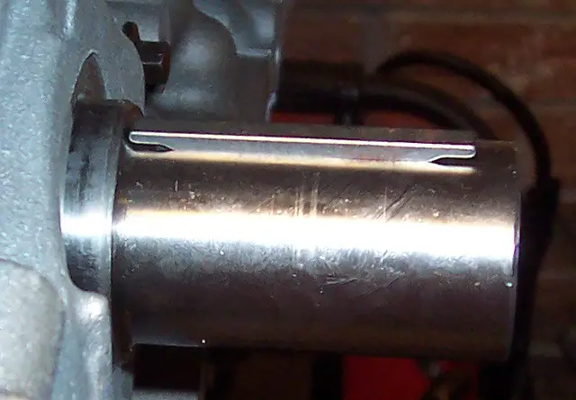

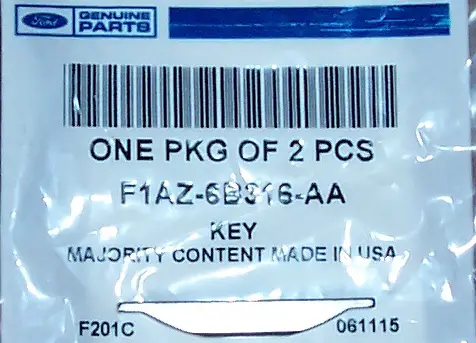

My new crankshaft did not come with a woodruff key so I had to order a package of two from the Ford dealer. P/N is F1AZ-6B316-AA.
I tapped into the crankshaft slot.
I haven't test fit the crankshaft sprocket yet. The key looks like it might be a little high. Do you know which way the crankshaft sprocket goes? Does the flange without the sprocket go forward? The Aviator shop manual words don't match the drawing and I wouldn't trust it anyway. One drawing showed the driver side large sprocket being installed on the inboard camshaft. The 2003 Explorer shop manual contains the same crankshaft sprocket conflicting explanation and drawing.
EDIT: Never mind. My 2002 Explorer shop manual CD has the same drawing but the text states that the timing mark on the sprocket should face forward. The arrow in the drawing is to identify the timing mark and not the direction of forward or aft.
