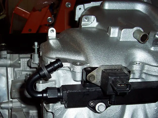

It was part of a cooling kit from Auto Zone that includes a new fan clutch. I also started working on the fuel supply system. There are interference issues with the Aviator fuel pressure temperature sensor (FPTS) being installed on the Mach 1 intake manifold/billet fuel rails.
The body of the FPTS is wider than the space available. I was hoping to connect the FPTS pressure signal to a pulse width modulator (PWM) fuel pump controller to control the pressure of a high flow pump like I did on my 2000 Sport for the supercharger. Utilizing the available 90 degree adapter would probably result in the FPTS interfering with the valve cover.
I'll try cutting off the excess of the FPTS mounting plate next to the manifold and adding a spacer between the manifold and the fuel rail. Hopefully that would not impact the alignment of the injectors between the rail and the manifold enough for the injectors to leak. I've decided it will be too crowded in the front for a fuel hose there connecting the two rails.

It looks like there is plenty of room to use the 90 degree adapter after all so I ordered one.

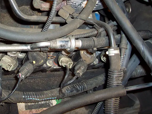

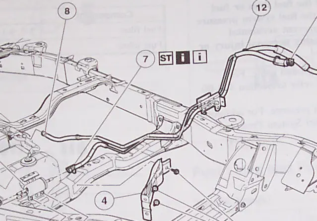

The Centennial fuel supply fitting is the standard Ford 1/2 inch diameter quick connect.
The supply tube is flexible back to where the bend starts near the firewall.
I may be able to twist and bend downward the supply tube to gain enough room for an 8AN to quick connect adapter to a straight, 45 degree or 90 degree female coupler to an 8AN Tee fitting.

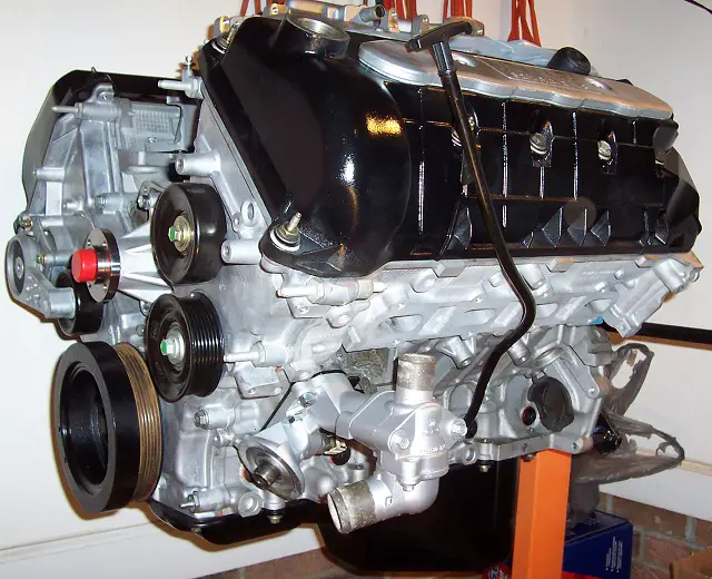

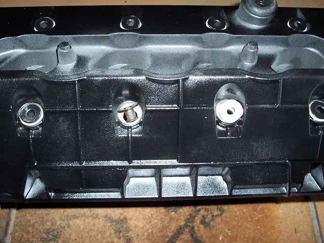

There are bushings that prevent the valve cover fasteners from crushing the grommets. The Victor Reinz valve cover gasket set includes replacement grommets. It took a while to push out the old grommet assemblies, replace the old grommets, and then get them seated in the valve covers.
Unfortunately, when I purchased the valve covers from the salvage yard I didn't notice that one of the grommet assemblies was missing. It will probably be challenging to purchase just one bushing. Although not even mentioned in my Aviator shop manual the large cup seals are essential to keeping oil out of the spark plug wells.
The peripheral gaskets encase the sealing ridge with an oval that in my opinion eliminates the need for the application of sealant where the head and the timing cover meet.
The MK VIII valve cover fastener set I purchased only includes 4 stud bolts while the Aviator shop manual shows the utilization of 9. I installed them at the front to position the passenger side wiring harness that goes to the A/C clutch solenoid, crankshaft position sensor and the driver side wiring harness that goes to the camshaft position sensor, oil pressure switch. I'll probably need to purchase a few more.
I installed the COPs and boots purchased used from a MK VIII. I painted the Aviator COP covers with aluminum colored engine paint. I won't torque the valve cover bolts until the fuel rail configuration is completed.
I had to use one of the valve cover stud bolts to secure the Aviator oil dipstick tube so now I'm one short.

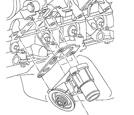

I purchased some flange bolts from Auto Zone and installed the oil filter/coolant adapter with a new gasket. I used medium strength thread lock on the new exhaust manifold studs.

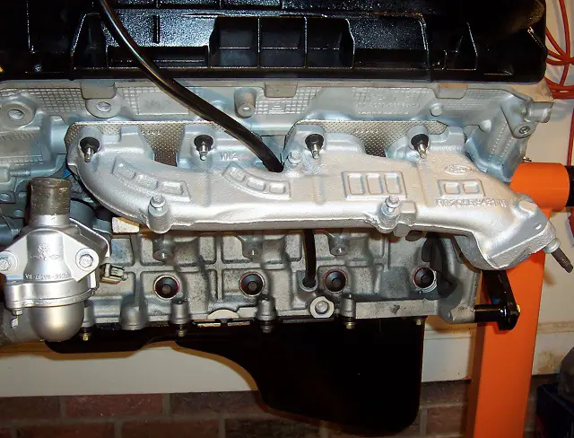

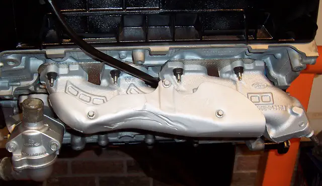

I painted the exhaust manifolds with aluminum header paint and installed the left one with new gaskets.
The new exhaust manifold nuts are self locking. Hopefully, once the thread lock dries it will be strong enough to retain the studs if the nuts are removed in the future. I also painted the heat shields with aluminum header paint.
One of the heat shield mounting bolts on the passenger side exhaust manifold broke when I tried to remove it. I'll have to drill and extract the bolt if I can find an extractor for an M6 bolt.

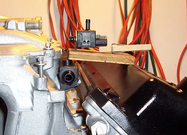

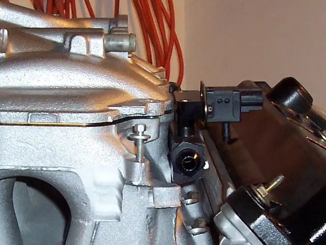

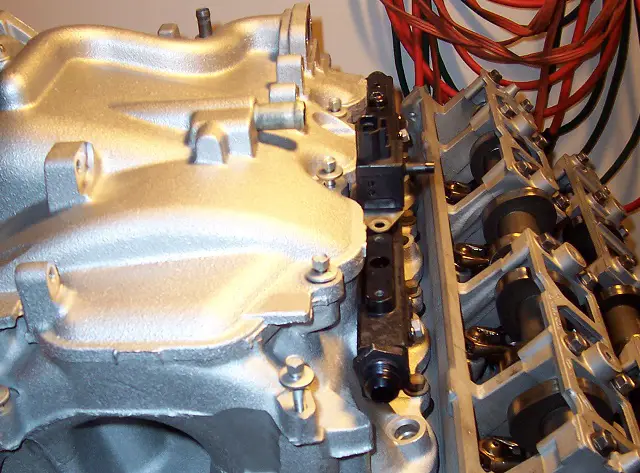

The 90 degree FPTS adapter arrived so I test fit it and learned that a ridge on the plenum interfered with it.
So I removed the plenum and filed off the ridge and gained several thousandths of clearance. The fuel port on the FPTS is offset from the mounting holes so it can only be mounted with the vacuum port down.
You can't tell from the photo but there is about 1 inch of clearance between the end of the port and the valve cover. That should be enough room for a vacuum elbow. I'm reconsidering my decision to connect the left and right fuel rails across the rear instead of the front. A Tee on the left rail limits the possible angles for connecting the supply adapter to the left rail. Using a 90 degree fitting allows more freedom. Also, the plumbing associated with the cooling mod, the EGR tube and wiring harnesses all have to fit between the firewall and the rear of the engine. Its pretty crowded on the Centennial which doesn't have the coolant mod plumbing.

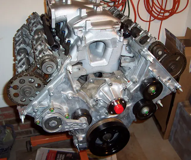

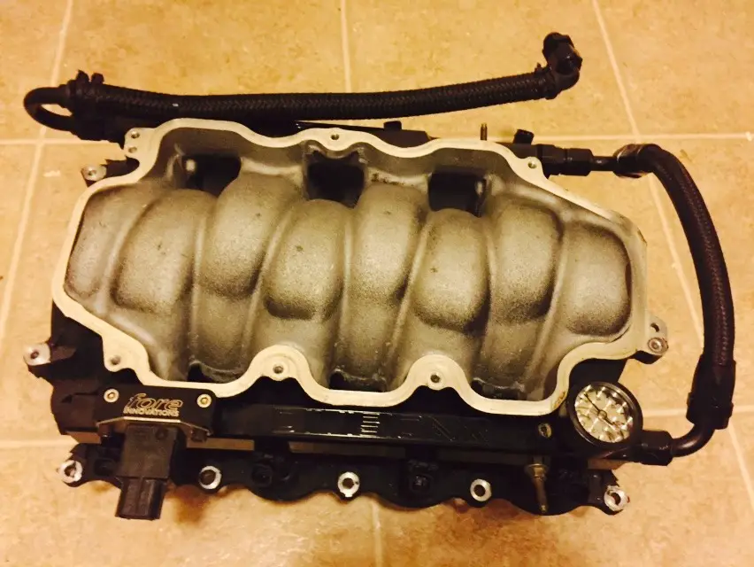

Today I test fit the new aftermarket Aviator crossover tube and was thoroughly disappointed. The tubes that mate with the crossover ports are at different angles than the ports and not the correct length to align the main tube with the front of the block.
Also, the heater outlet tube is directly above the valve cover retaining stud bolt as shown above and in the blurry photo below.
If the outlet tubes were actually seated in the ports the crossover tube would be almost touching the top of the stub bolt. Also, there's no room room for the fuel rail crossover to be in front.
I found a photo of my fuel rails mounted on a Mach 1 and the fuel crossover is at the rear.
So I guess that's what I'll have to do.

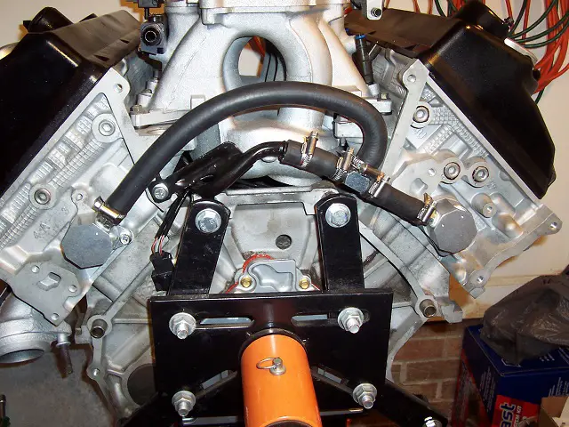

I've decided not to use the Aviator crossover pipe assembly because I want to implement a hot temperature thermostat configuration instead of a cold temperature thermostat configuration. I'll use the stock Explorer coolant/oil filter mount adapter (shown below) instead of the Aviator one.
I've found several inline thermostat housings but only one with an integrated Y combiner.
So I ordered a two sensor kit from On3 Performance. The kit I ordered contains two of the driver side adapters and no passenger side adapter. I'll use the temp sensor port on the driver side for the heater hose supply. The stock Explorer relies on the cylinder head temperature sensor and doesn't have an engine coolant temperature sensor so I'll plug the driver side adapter sensor port for now. I may install a sensor in the future to activate an electric motor driven radiator fan or to monitor actual engine coolant temperature. The intended routing for the thermostat and feed lines from the heads is shown below.

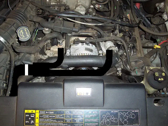

While in the process of preparing to pull the Centennial engine I remembered I was told that the power steering pump for the 2 valve is not compatible with the 4 valve engine. Today I purchased a 2004 Aviator power steering pump with mounting bolts and fluid reservoir with mounting bracket on eBay.
I'm hoping that the Explorer high pressure tube/hose will fit the Aviator pump.
