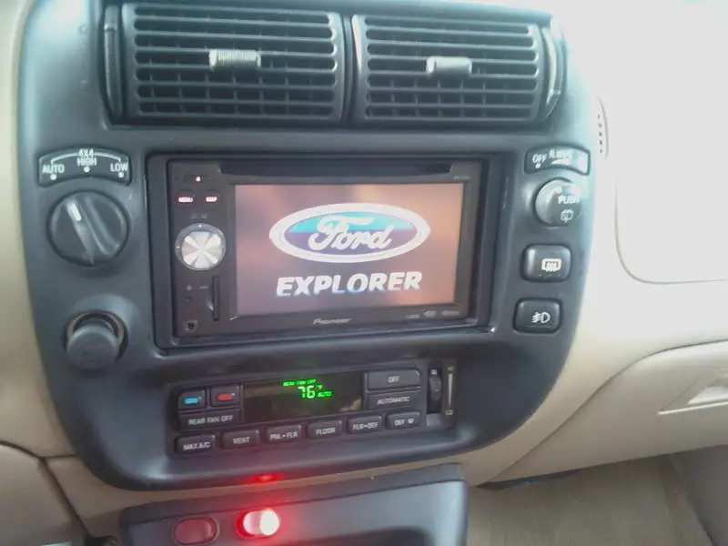

Just put an AVIC-F700BT in my 2nd Gen. Used the Metra 99-5805 dash kit. There was a little lip that prevented the AVIC from fitting all the way into the trim piece, but a little bit of muscle and sanding made it fit perfect.

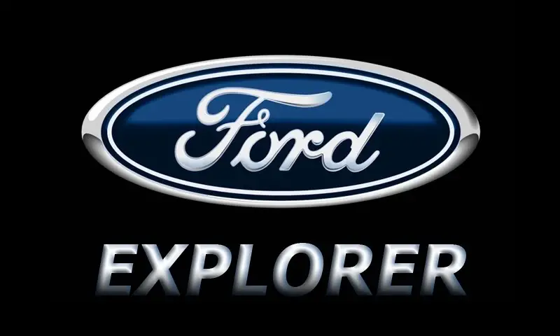

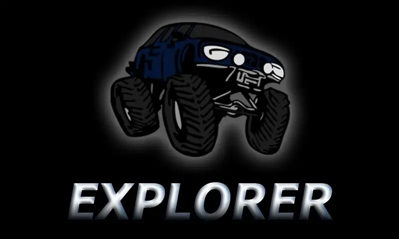

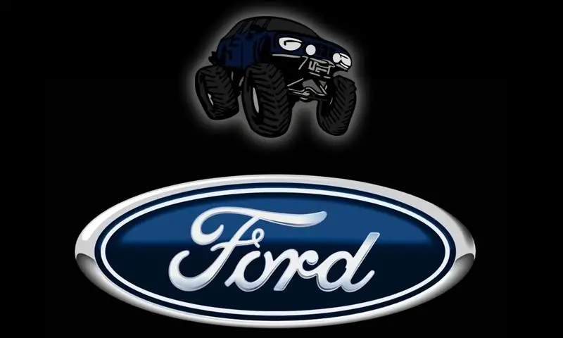

I'll get pics next time I'm in the truck, I also made a few nice Ford Explorer splash screen for AVICs, but I'm sure it can be resized for many others too.
Nice!
Thanks guys, Feel free to sticky them or whatever, and if needed I can do some more, just give me the art.
