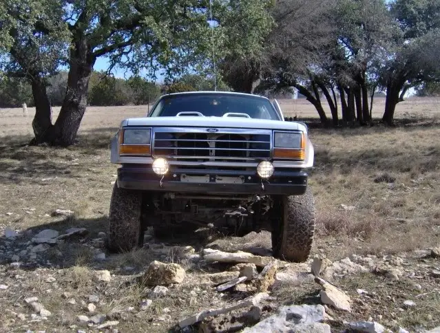

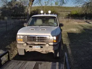

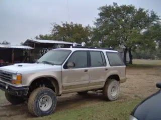

Been working as mother nature allows, was able to take the rig down some back roads and run it, that gave me a chance to figure minor faults out. The rear shocks have been replaced, with Edlebrocks IAS, was able to find the type Jack had installed from his registary, (lifted F150) and ordered a set, at 60% off! Got the off road lights installed and wired. (Top and rear, the front ones were already hooked up) The top ones are mounted on electrical outlet boxes from Home Depot and then secured to the roof rack, I just don't trust 4 screws alone to hold them in place in case of a sudden stop. The rear ones are mounted on electrical boxes also, but are much lighter and secured with the 4 screws. I used bicycle innertube as a gasket between the boxes and the roof, and then a crap load of black RTV. Been raining for two days and no leaks.

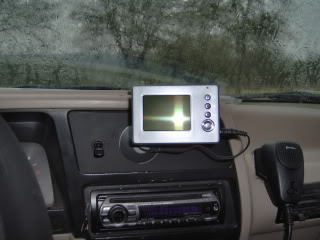

Ah, the camera location has been decided, but not connected yet, the LCD display tho was easy, I took the electric 4 wheel engage panel out, cut out a new one to fit, tapped the LCD into the 4 wheel harness and that was it. Wasn't going to use the cigarette plug in on this and have a wire getting in the way. The suction cup for mounting the LCD was thrown in the trash and the screen was bolted on. There is a toggle switch there to the left to cut the power to the LCD.

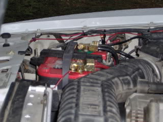

The optimia battery, the middle series, not the super dooper style, it works excellent for what I need for the rig. Did go with the 24k plated battery terminals, these also hade the twin slots for cables.

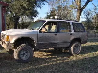

Forgot to add, over blacktop and improved road, the rig rides stiff but handles excellent, didn't get over 65, but that is a good speed. Over rough ground, it's like the rig is picking it's own way, response is excellent, moves smoothly, and when running thru a creek, really cool!!
I'm really liking the camera monitor mod, very nice.

I almost got a set of duel battery cable connectors, but the optima has side terminals as well, so I just ran a cable off the side post for my accessories.

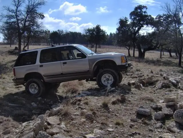

Good news: this rig loves wheeling, the handling is great, it was muddy and the rig grabbed it's way thru.
