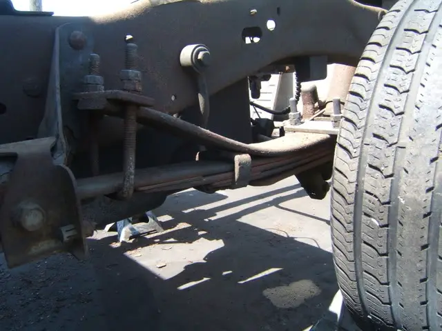

This was my cheap fix for wheel hop on my Ranger:
Its a set of helper springs turned around and flipped upside-down on the front of both springs. I never got ANY wheel hop after that. Trust me I tried ... everyday.
Now that is an interesting idea. Since I am looking to swap my rear end and do the SOA, I'll make sure I address weak springs.
I wonder how F150 springs ride on a 4 door? Comparable, softer, firmer...? Sounds like a cheap way to go since I have heard that cheap replacement springs sag quickly over time and I don't want to mess around after I swap and upgrade axles.
There deffinetly firmer. But they eliminate sway. Its a firmer bit good ride. Rides like a truck should
