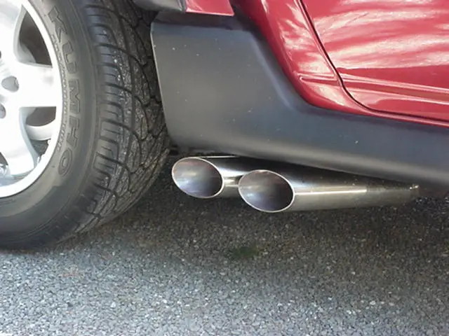

With the SOHC engine, anything more than 2.25" is not needed. Our engines will lose torqe when back pressure is not there anymore. I got the Flowmaster 50 series duals out the rear to the side. I have dual 2.25" pipe so I did lose low end toque but gained high end power. I got the exhaust mainly for the sound/looks so I am not dissapointed...Its not like my expo is a race car or anything.
if you wanted to see how the pipes were routed and keeping the spare tire go here http://www.explorerforum.com/forums/showthread.php?t=135147&highlight=exhaust

My entire system is about 4 FT long total (Enc the 2 dual outs) works very well,trac makes 224.4 RWTQ, about as good as it can get in a N/A mode
