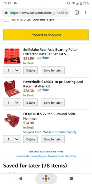

Just to get this straight these are the specialty tools I will need?
Slide hammer to pull axle bearings
Axle bearing and seal installer kit
Think I can nab these for around 100.
Anything more?

I have the axle up on stands and took the diff cover off to drain out. I went ahead and ordered the slide hammer, bearing and seal removal tools, bearing and seal installation tools. 1 magnetic retrieval tool. 2 bearings and seals and 1 crosspin bolt. (So I am waiting on those). I bought the tools because I don't know how long this will take me and I don't want the auto store giving me grief. Plus.. now I have the tools forever.
