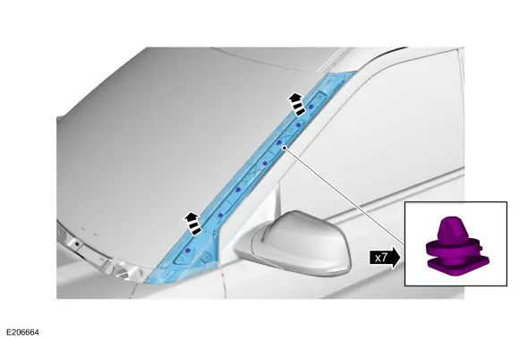

So my 2015 Explorer Limited just had the Passenger A Pillar Trim(One that runs along the windshield) fly off while I was driving. This was a salvage title but I've seen the pictures and I know that this part of the car was never touched so kind of confused how this happened. I also know it won't be covered under warranty(Since there is none). Does anyone have the part numbers for the Trim and Clips so I can buy them and put them on?
www.fordparts.com, enter your vin and then do a search
Bb5z7803136ab

The retaining clips should be: BB5Z78519R44A

Got the model number for the clips needed, anybody know the number for the plastic subpanel the a pillar attaches to? (Its mounted with 8mm bolts) i can't find it
Went to dealer, ordered bb5z 78026a52 a
And the clips above, hopefully the right stuff
ordered a part on 11/17/15 and just came in and it was WRONG. Bb5z7803136ba hopefully is correct at $111.75,$16.43 for clips, and just over $100 for the exterior pillar, $250 cosmetic fix, I just feel dumb.

If you are going to replace the 'A' pillar trim piece you will also have to get new plastic clips as well to hold it in place otherwise you risk having it blow off. These trim pieces have blown off before. Not sure if the clips are included with the trim piece now.
