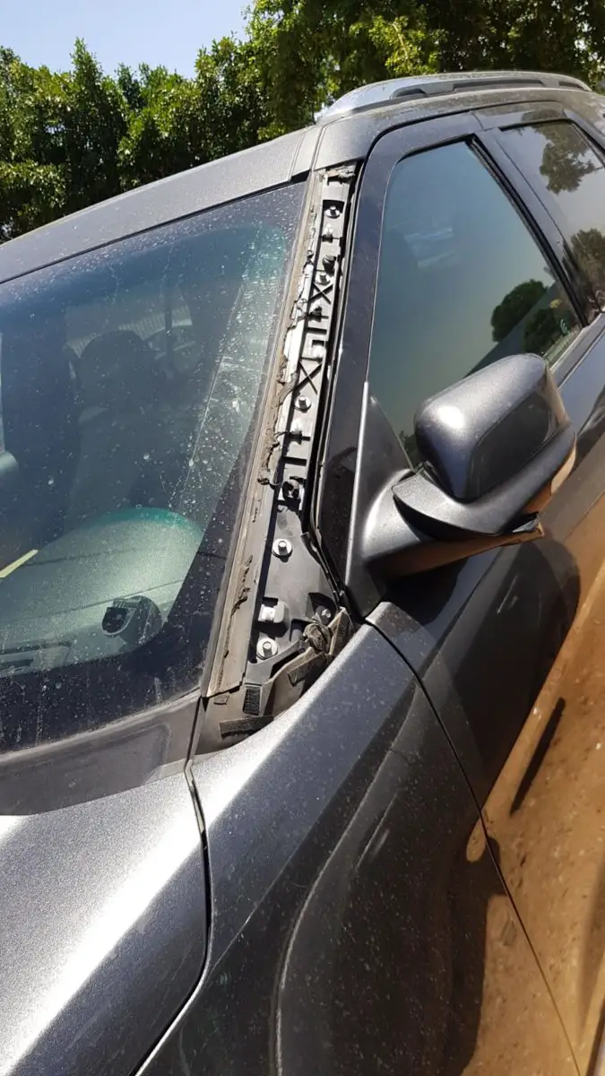

I just bought a 2017 explorer platinum trim used and noticed that the top portion of the outer trim was not flush. I called my local ford dealer for an appointment at 715am on 5/26/22 and when I got there they advised that it might be a day or 2 to get the parts. I said I already called the parts dept and they are in stock. They then stated that they would need the vehicle a day to get this replaced. What is an appointment for if you cant work on it until next day. Unsure why I thought they would do it on the spot but I just bought the parts and went home to install. Took 30-45 minutes to install and good as new now.Hi guys,
Anyone knows part number / name fo this part?
Cannot find it (searched for all body schemas on exterior parts).
It is explorer 2017
Thanks for helping

How much were the parts if you dont mind my asking.I just bought a 2017 explorer platinum trim used and noticed that the top portion of the outer trim was not flush. I called my local ford dealer for an appointment at 715am on 5/26/22 and when I got there they advised that it might be a day or 2 to get the parts. I said I already called the parts dept and they are in stock. They then stated that they would need the vehicle a day to get this replaced. What is an appointment for if you cant work on it until next day. Unsure why I thought they would do it on the spot but I just bought the parts and went home to install. Took 30-45 minutes to install and good as new now.
