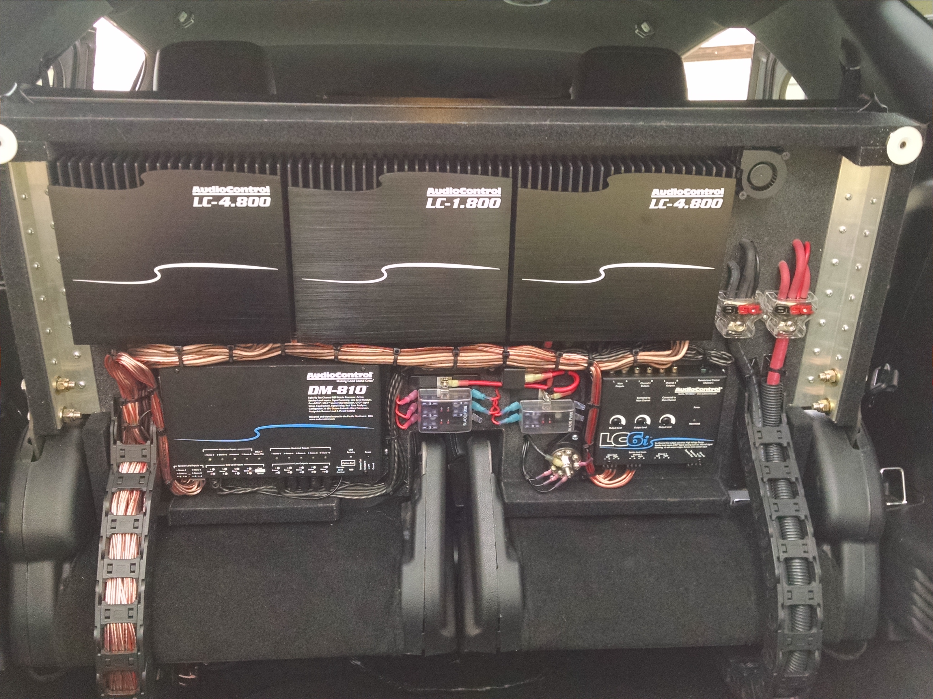

Hello All,
I want to thank everyone for all the great info. I read everything I could find before starting my project to upgrade the stereo. While I respect everyone's opinion regarding what their ideal system would be, I had my own criteria:
- Retain spare tire
- Make system invisible when not in use
- No loss of Ford Sync functionality
- ROCKIN' GOOD SOUND!
Since my Explorer is my daily driver, I have little to no use for the third seat position, but wanted to keep the power-fold third row seats. My option was to remove the third row seat backs and create my own "single seat back" for mounting the equipment. Real estate was a challenge, as was cable movement when stowing the system. I ran 1/0 pos & neg cable directly to the battery, which will help to eliminate ground loop noise. Also, all speaker wire was replaced with minimum 12 ga. (subs are 10 ga.) and all speakers were replaced with Focal. I would be happy to answer any questions regarding my system and how I got around some hard spots.
If someone can tell me how to upload a photo or two, I'll show what I did...

O.K. - the photo above shows the system (seat) in the raised position.

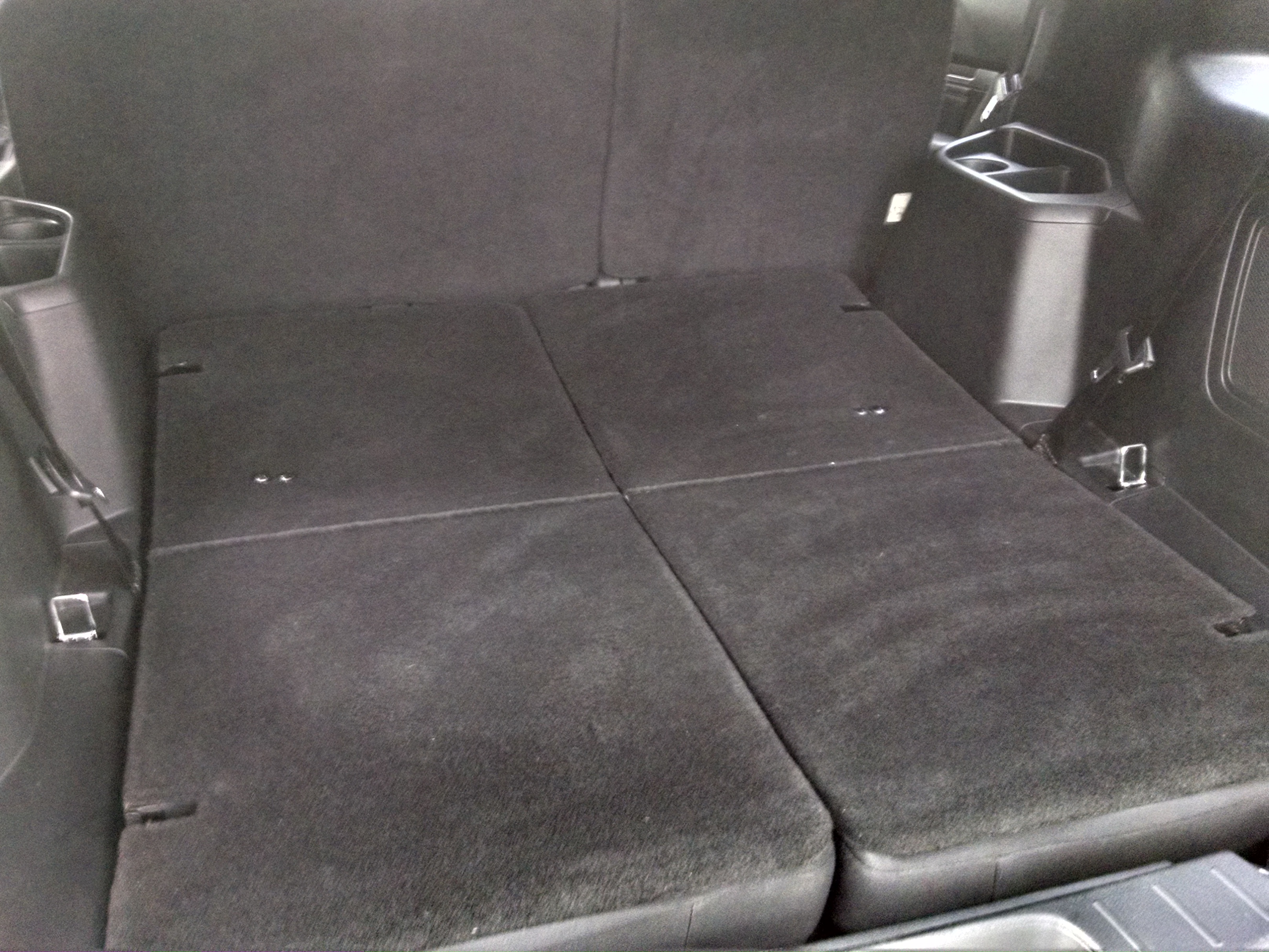

And in the stowed position.
