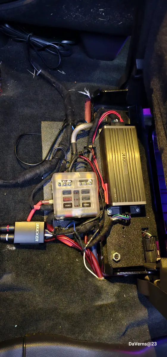

QUOTE="daverns, post: 3551371, member: 248381"]A few weeks back I upgraded the front and 2nd row speakers with JBL 6x9 (front) and 5 1/4 for the 2nd row, the sound is now clearer but still missing bass, so I am planning to install a sub with built in amp, choosing between the JBL SL8 or the Kenwood KSC SW11. Last week end I did the install prep while deciding on the sub, installed the Line converter to RCA Kicker SLOC and the power cable to the battery. I was able to use the grommet at the back of the glove box used for the rear washer hose, it's very hard, I followed a tip from the previous post, where he loosen the clips of the washer hose, then pull out the grommet and cut a hole in the grommet, and insert the 10 gauge wire (these subs only require 12 gauge) far enough so I can reach it from the engine side, before putting it back I put in silicone to seal it. It was also hard to put back the grommet since I can barely reach the hole to put it in. I was planning to take pictures of the grommet but forgot about it, since I am tired and sweating so much (Texas heat). Hoping to install the sub this week end.
I decided to install the Kenwood KSC SW11, it's much cheaper than the JBL SL8. Completed the install yesterday and I am happy with the result. You can now call the sound as PREMIUM. I installed it under the middle of the second row seats, it fits nicely, it has about maybe 1.5 inches clearance between the sub woofer and the seat.

After a few months, I added the kicker key 180.4 and a new sub woofer with built in amp. Sounds amazing now...
