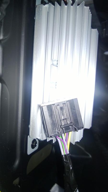

I took a look at the factory amp. I have the non-Sony 8 speaker.
The vehicle has 7 wires entering the amp.
1. Solid yellow (RF -)
2. Solid purple (RF +)
3. Purple w/red stripe (Amp turn on)
4. Solid green (LF +)
5. Solid gray (LF -)
6. Gray w/red stripe (12 volt radio ?)
7. Black w/yellow stripe (unknown)(ground ?)
The vehicle also has 4 wires exiting the amp.
1. Solid white (LF +)
2. White w/brown stripe (LF -)
3. White w/orange stripe (RF -)
4. White w/purple stripe (RF +)
Does anyone know what these wires represent? And how can 4 wires leaving the amp power all of the speakers?
Edit
Added some of the wire functions. http://www.the12volt.com/installbay/forum_posts.asp~TID~125888
7. I am just guessing.
Also added photo
The amount of wires, in or out, does not make sense. I could see 4 pairs of wires being the input. It is likely the non sony system starts out as a simple fron L+R and rear L+R. The out on the amp should have at least 2 pair for the front doors (thats a minimum assuming the crossover network is located in the door to seperate the tweeters and woofer). A pair for the center, the rear could have some tricky wiring as the rear fader only controlls the"rears" (that would include the rear doors and 3rd row speakes). If they are wired in series than the amplifer may only have 2 pairs of wires for all 4 rears.
I cant see that happening as the wiring is much easier if it all gets home run back to the amp. This also gives them the abillity to set the levels and individual crossover points( 3rd row speakers dont produce much, if any bass. They are just for fill.
