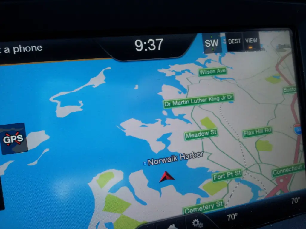

Just curious, did you notice if you had acquired GPS? Did you have the icon "GPS with a red X through it"?
It had acquired GPS. In fact, I have never seen it display the the GPS with a red X symbol. It can precisely track the location on a straight road, but when the road curves or I make a turn, the nav location often keeps going straight into a field, a lake or a nearby road. The system then believes that it is off-route. This occurs on perfectly clear days in areas with no obstructions.

I have lots of similar photos and will start building the paper trail for a lemon law complaint in case this isn't resolved soon. It is interesting that yours showed that it didn't have a GPS lock. Mine has never displayed that, but it cannot accurately track the location even when it finds 9 satellites.
I had no gps reception a majority of the time. The most satellites it was ever able to see was 5.
