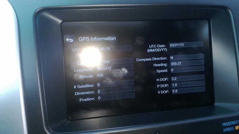

I certainly hope this January timeframe is not correct, because my Sport that has a date on the window sticker of 20130220 has got GPS tracking issues. Just recorded a video of it today, where the NAV had me about 1/10 of a mile behind actual position, so when I turned onto a side road, I was driving through a field on the map. I've never had the GPS icon show up on my screen (with or without a line through it), and yesterday when I got home (and after driving through a golf course) I went into the diagnostic mode and the GPS showed the picture attached.
That sounds like the symptoms on mine, which was built in November, except that my nav shows the vehicle ahead of its actual location. I have also never seen the GPS icon and usually have 8 or 9 satellites. I should know by Monday afternoon whether the TSB fix solves the problem.
