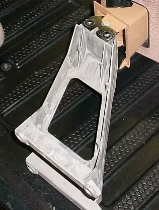

Any pictures where the bolt holes are and how the center console mounts. I am going to try a go to some junk yards Monday and see what I can find. It will save some time not having to figure how to get the console out. Maybe a pic of the old console mounts and the new one.
Only these ...........

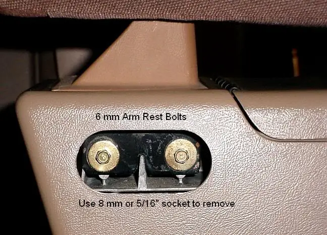

Tools needed: 8mm or 5/16" socket with ratchet, and extension if preferred, and a Phillips screw driver.
Arm Rest mounting bolts, two per side.

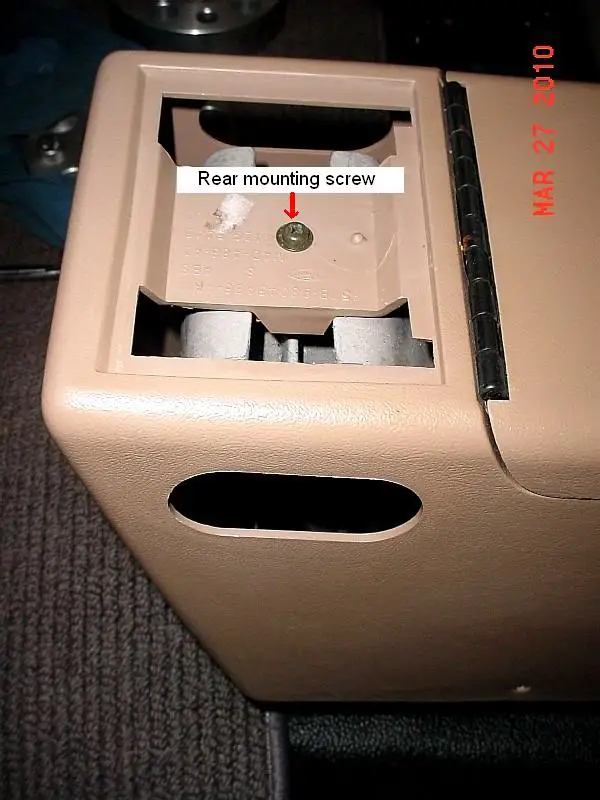

After removing the arm rest there's one screw.

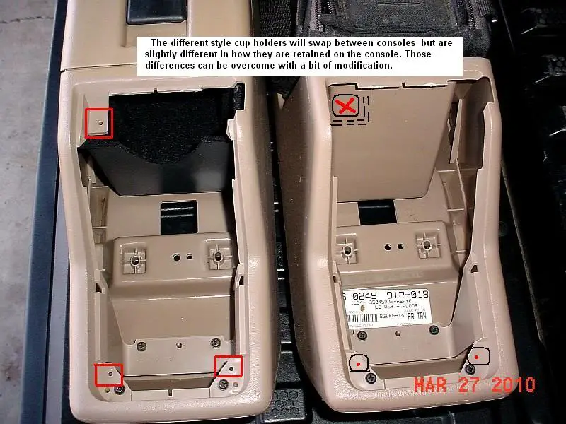

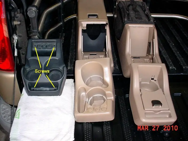

Depending upon which cup holder tray is on the console there's four screws or no screws. The black cup holder has four and the interior colored cup holder has none & is removed by just lifting up on the front of it just like you do removing the one you have now.

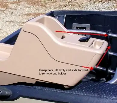

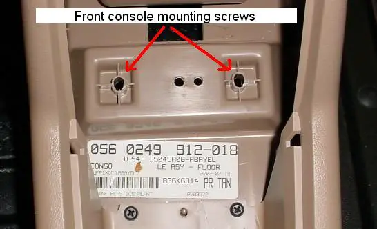

Once you have the cup holder removed there are two screws holding it it the floor.
Installation in the reverse You can actually remove/swap these consoles in about as much time as it took for me to upload and post these photos. So simple even a Caveman can do it .......
Both consoles mount EXACTLY the same ......... same screws, same bolts, same holes, same everything!
You do not even need to change the aluminum bracket.

Will the 2 cupholder shorty console from say a 03 xlt ranger fit up front under the dash? I think I know my next mod if it does. I like the bag, I just wanna change the cupholder part to that style like the black one up there ^^
I'm not familiar with the Ranger consoles, never seen a Ranger with bucket seats & console that I recall. "Supposedly" the consoles are the same design as the Explorer consoles. The black cup holder shown above will "fit" the bag console. Notice in the console comparison photo below, the screw holes in the very front and rear corners of the open cup holder area of the Explorer (Ranger?) console that aren't there on the bag console.
No, I'm talking about the 2 cupholder console that goes under the dash below the radio bezel. Just a thought I had, because I have an old black one that would fit in my grey st interior. Except for ones with the full-length console, all Rangers all had 60/40 seats I'm pretty sure
