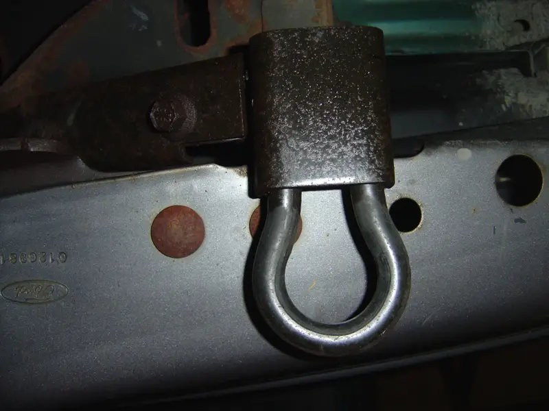

It is a universal loop from Summit Racing.
I had to drop the front of the tank down.
It is bolted to the floor, not the frame, but it is bolted to a spot right up against a reinforced area so it should be pretty sturdy. Hope to never find out.
I believe according to NHRA standards that the loop must be within 6 inches of the first u joint, and it is on my truck.
