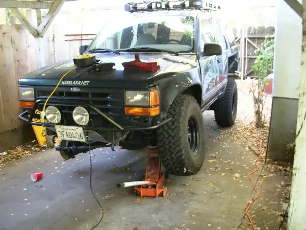

here's my **** as of now...1.5" per side widened beams...picked em up from a good buddy for a great deal. Baja Concepts but I guess Camburg makes em'. I just can't get away from Camburg lol :D

Josh, thats awesome, huge improvement over your old setup!
4x4 working? hahaha
Stock explorer pivot brackets?
Are those bushing type arms?
How it the tubbing of the back coming? you going fiberglass back there??

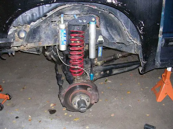

The Autofab kit does not need to be installed in-house. It can be done at home in your driveway. As far as trimming the frame, it's minimal and not a big deal at all. Here is a pic of the conversion parts I'm using. The radius arms and radius arm pivot brackets are Autofab, the Passenger beam pivot bracket is an Autofab bracket that I modified and the Driver side beam pivot bracket is an OEM STX bracket that I also modified for the conversion.
Josh, is that last pic at full bump?

My original plan was to use a coil-over, but I'm still going back and forth. I like the adjustability of a coil-over, especially since this thing is going to sit pretty low. But...I like to be different AND Autofab is making a really *****en coil-bucket specific to the D44 conversion. I wouldn't be surprised if I ended up with the Autofab axle housings and coil-bucket when it's all done. It's just so much easier to bolt stuff up and go pound the hell out of it....
Yah that pic was full bump. It looks like it could go further, but I'm happy that my tires FINALLY aren't rubbing anything at bump. Also that's with the shock having probly 1/2"-3/4" left on the shaft. I'm not really trying to go full-on race or anything cuz it's a 2-door, but it works pretty well. I just got back from smashing around at a local crappy offroad spot and it did pretty well! I'm sure it will be much better after I have more than one rear shock on there ;) ...did impress some guys in a yota pickup and an oolllld school suzuki LC10(i think that's what my buddies said it was...ultra rare I guess) by crawling up a narly articulated muddy slick clay section. fun stuff!
the wheelwells leak a little bit like I knew they would, I just wanted to get some water and mud sprayin under there so it would make it more obvious where I need to work on.
I'm using stock pivot brackets, heimed radius arms with bushings in the beams...no fancy uniballs yet :)
