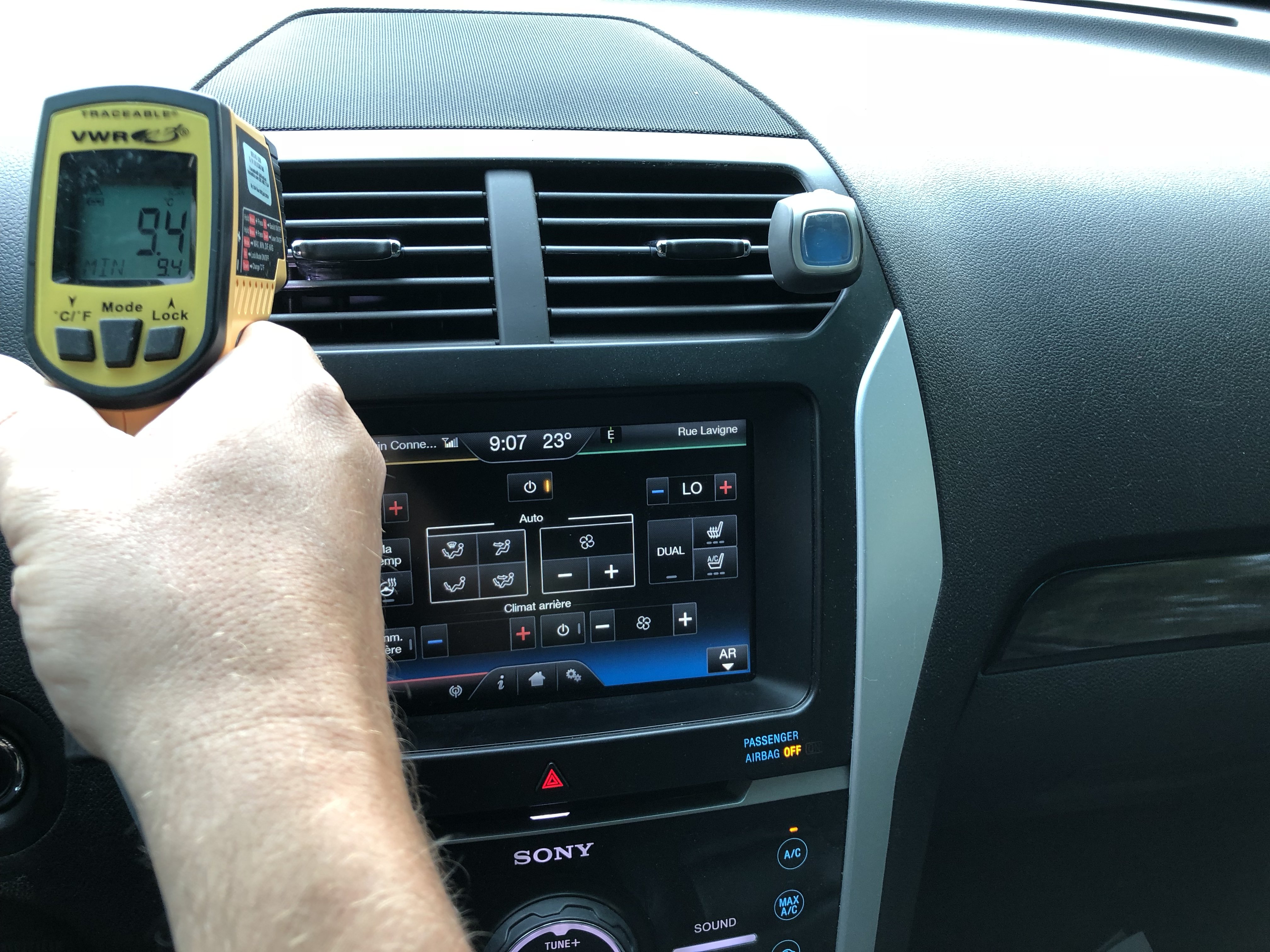

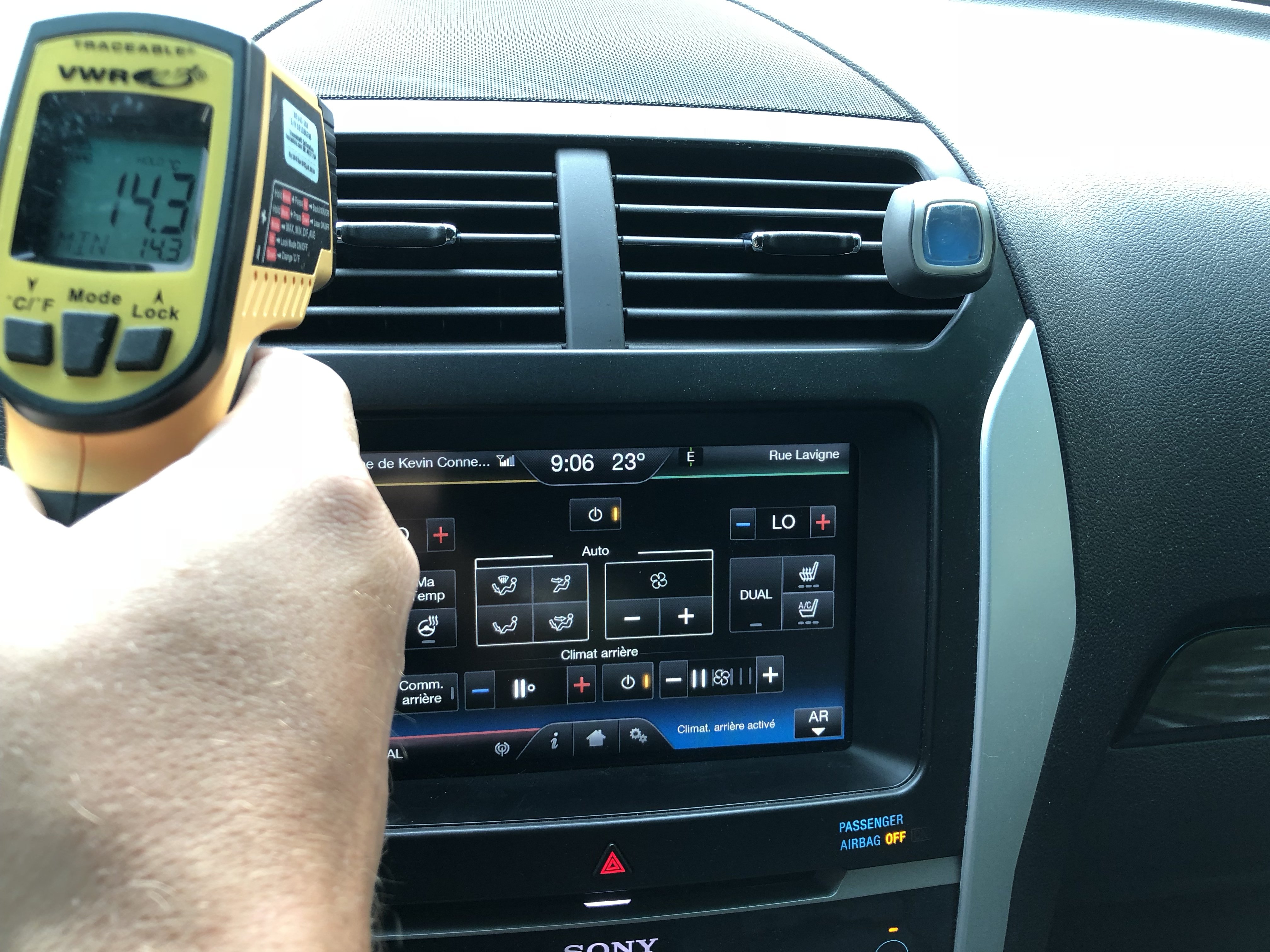

I noticed that in your pictures the temperature is set to LO. Does it make a difference if you set an actual temperature. Usually in 'Auto' there is a temperature reading shown there.

Yeah! As you saw the temperature was set at LO for only testing the lowest temperature could produce with only the front or both section. As Sheltonfilms says:
Using rear ac will raise evaporator core temps for the front unit. Both units have to share one condenser coil so the extra load takes a toll on the front core's cooling ability.
Within a few seconds after activating the rear AC I've seen evap temps raise 5+ degrees F.
As far as the condenser fan, yes there are two speeds. It has two different sets of windings on the fan and when demand is high enough the high speed is engaged (sounds like it's about to take off).
He just confirmed my thoughts about the temperature load with both units ON in a hot day
Thanks guys, Finaly everything is fine for me
