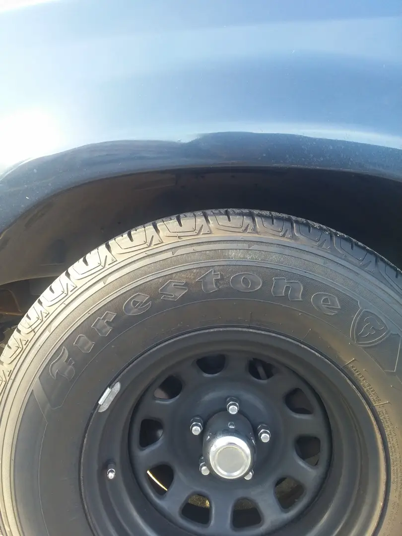

Thanks lol I like to call my truck a 5 footer since it looks good from 5 feet away..once your less than 5 feet away, you can see so many imperfections lol
Truck is dirty as usual as it just rained yesterday Smh lol
Rear wheel gap
Front wheel gap
