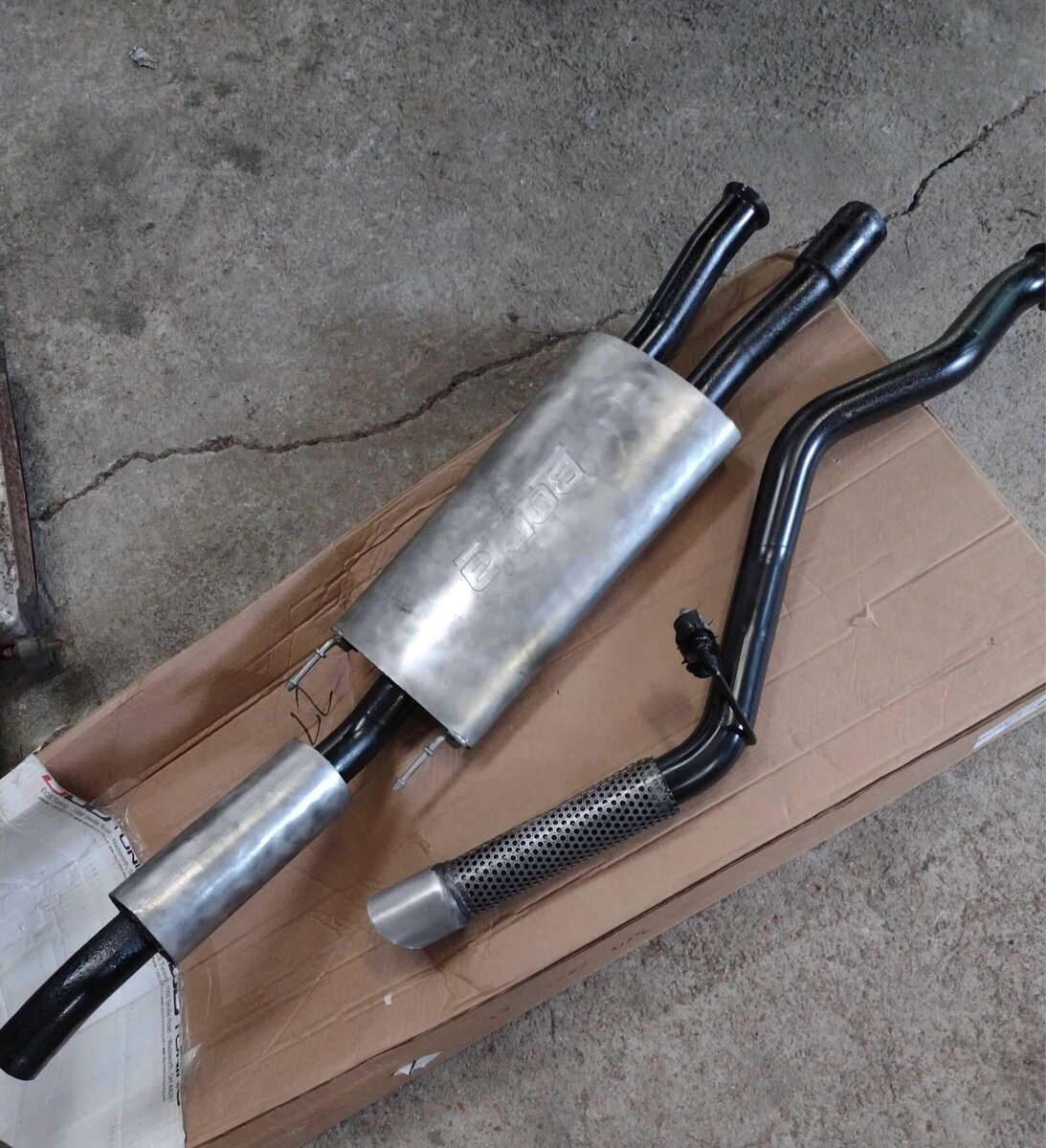

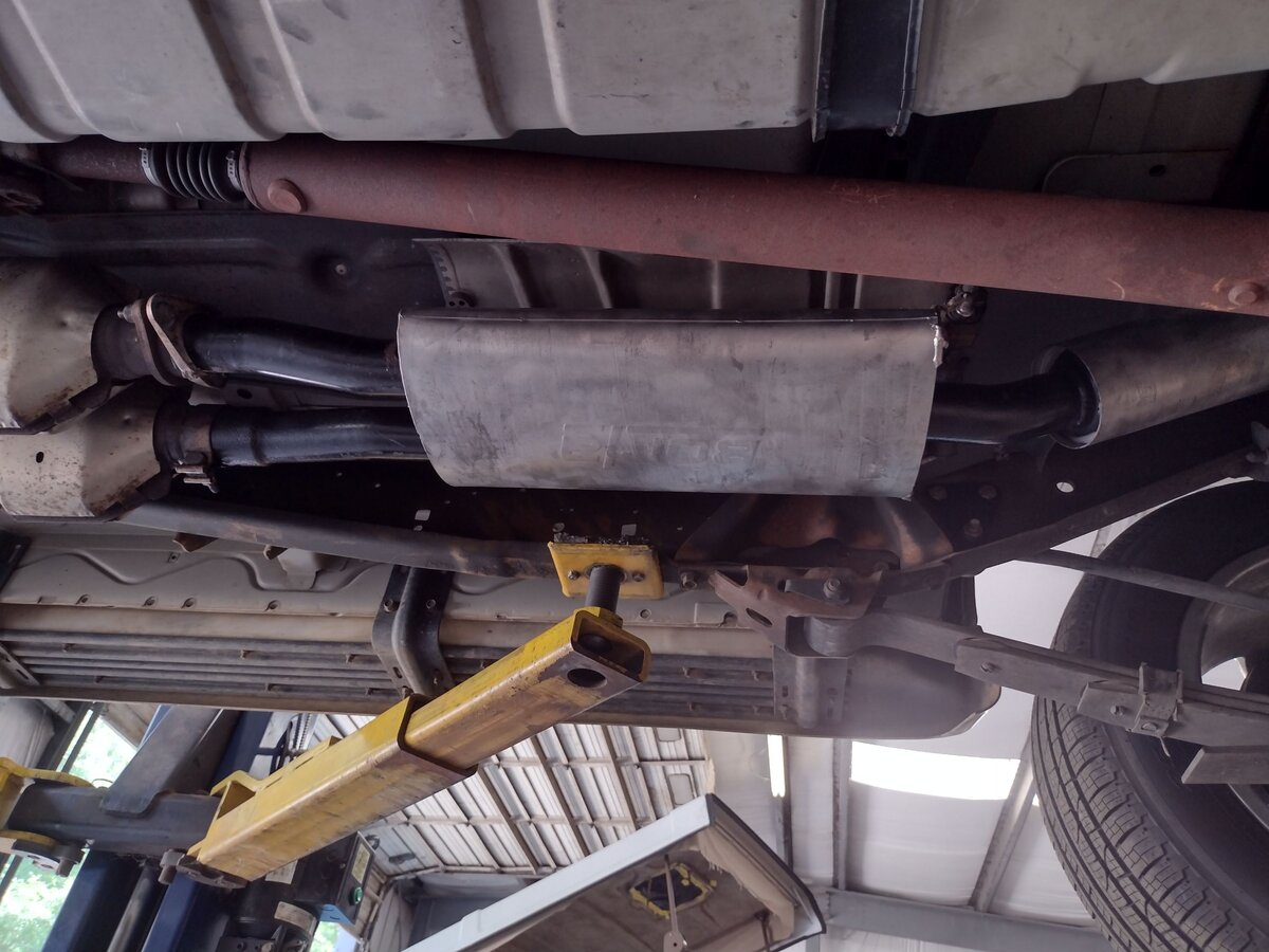

So spoke to the folks at Borla today and they seem to think this would be ok - but thought I'd run it again here. Here is my existing Saleen Borla system installed. It is a dual inlet - single outlet. I have a 2nd Saleen Borla System.
I intend to cap one of the inlets of the existing system and run the pipe going into that one into the second Borla system that also has one inlet capped. The tailpipe of that 2nd system will run along side at out the back beside the existing pipe. I assume I will have to stack both mufflers at an angle as has been mentioned here or perhaps there is a way to stagger them??
I hope that capping one inlet will be ok. Borla said their mufflers are straight through with not obstruction so ??

The muffler space is about three feet, and those are fairly long mufflers. So staggering them would be tough, one would be forward a lot.

I’ll probably leave it in. What do you think about my idea of capping off one of the inlets on each muffler and then maybe putting them side-by-side at an angle and running the single tail pipe from eqch out the back passenger side. I’ll have both matching tips right together there. Might be easier than trying to run one over to the driver side and having to deal with whatever would come up with unequal exhaust length

Only determined to keep my existing Borla and add the 2nd Borla because they both came off Saleen XP8s If these systems didn't come from the actual XP8's (with their unique machine gun tips) then I probably would be doing something completely different. I know not everyone would understand or agree with this.... but for me it's what I have in my head that I wanted to do.

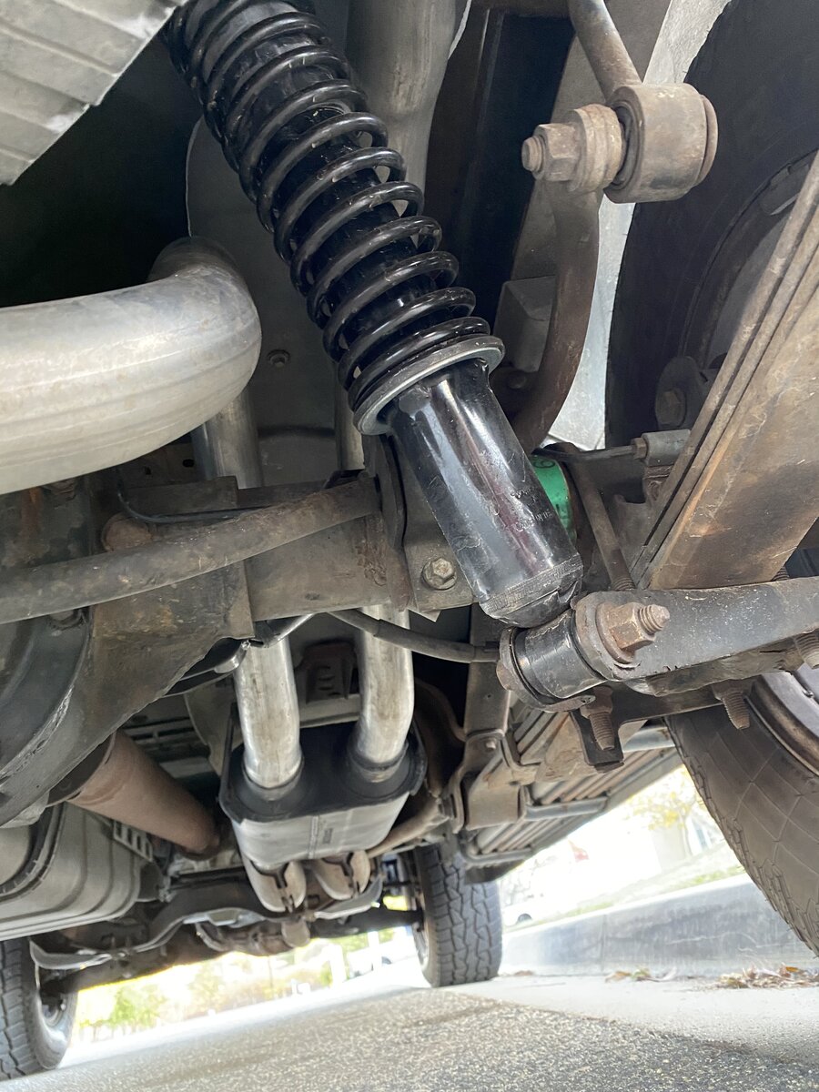

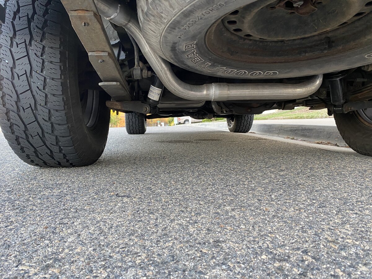

Getting reading to install the driver's side of a true dual exhaust system on my 2000 Ford Explorer Limited 5.0 and have been trying to find some photos of the driver's side pipe routing.
The 1st picture is what I am trying to accomplish that will route the driver's side high and behind the spare - allowing the spare to be kept.
Not sure who's truck it is - but this apparently is exactly what I need. I really do not want to lose the ability to have the spare or have the pipe cover up the diff and swaybar like on one of other photos in the previous posts.
I have availability to have piping mandrel bent with no issues.
Does anyone have any photos of how best to route the driver's side? I know there are concerns with the fuel lines, air suspension, etc that the owner of the truck in the 1st photo seemed to deal with - just cannot find anymore photos of his setup.
Thanks in advance.
Exhaust Routing photos please
Thanks in advance.
The pics I posted the spare tire re-mounts and clears it looks like the mounty pic you posted has the similar pipe route as mine, you can see the exhaust behind the rear-diff. The problem with that route is closer to your fuel lines.
