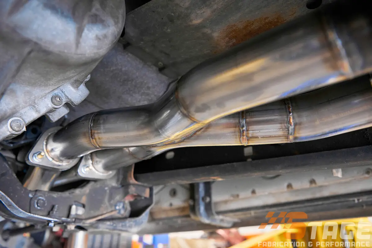

The placement of a cross over doesn't gain any power unless it could be right behind the header collectors, basically under the transmission bell housing. Where they all go is too far back to gain any airflow, but it does alter the sound. It can make it a hair quieter, or smooth out some rumble etc. The mufflers dictate the sound and level much more than the rest of the system. The cats and cross overs alter that just a little.
So I'd concentrate on doing it without any big restrictions in the pipe connections/joints. An "H" pipe is simple and easy to so without hurting flow at all. Some "X" pipes look tight, the curves and merge shape look a little "busy" to me. Make them big enough to match the final pipe sizes for that section.

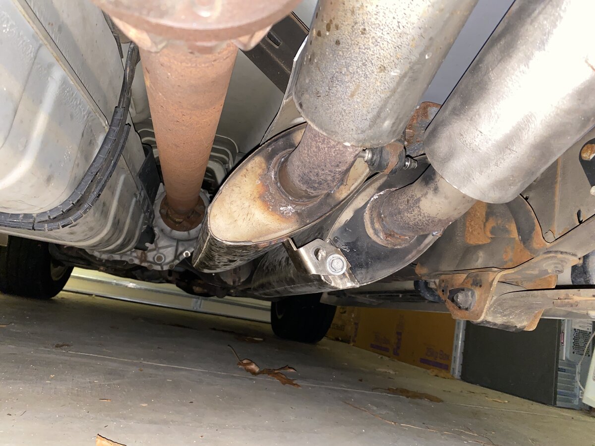

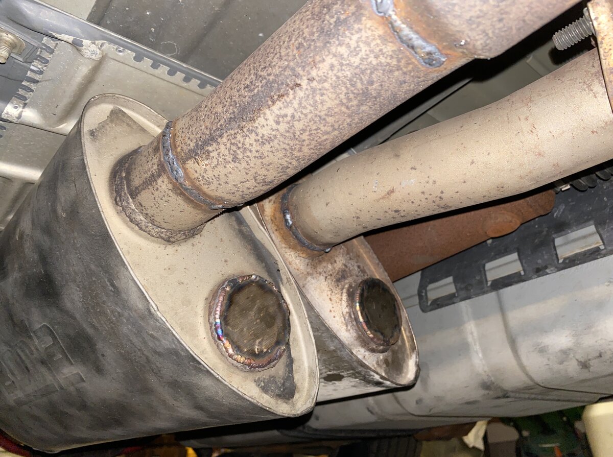

Another photo showing the muffler placement and how the second inlet was capped off on these Saleen stainless Borla mufflers. The mufflers are straight through with no internal baffles so was no issue with running 1 to 1 instead of 2 to 1

I've updated my exhaust to true dual's. Thinking it is going to even out and even improve the sound a bit. Tuner recommended X-pipe over H-Pipe but not sure why. Right now my torque at the wheels is 324ftlbs

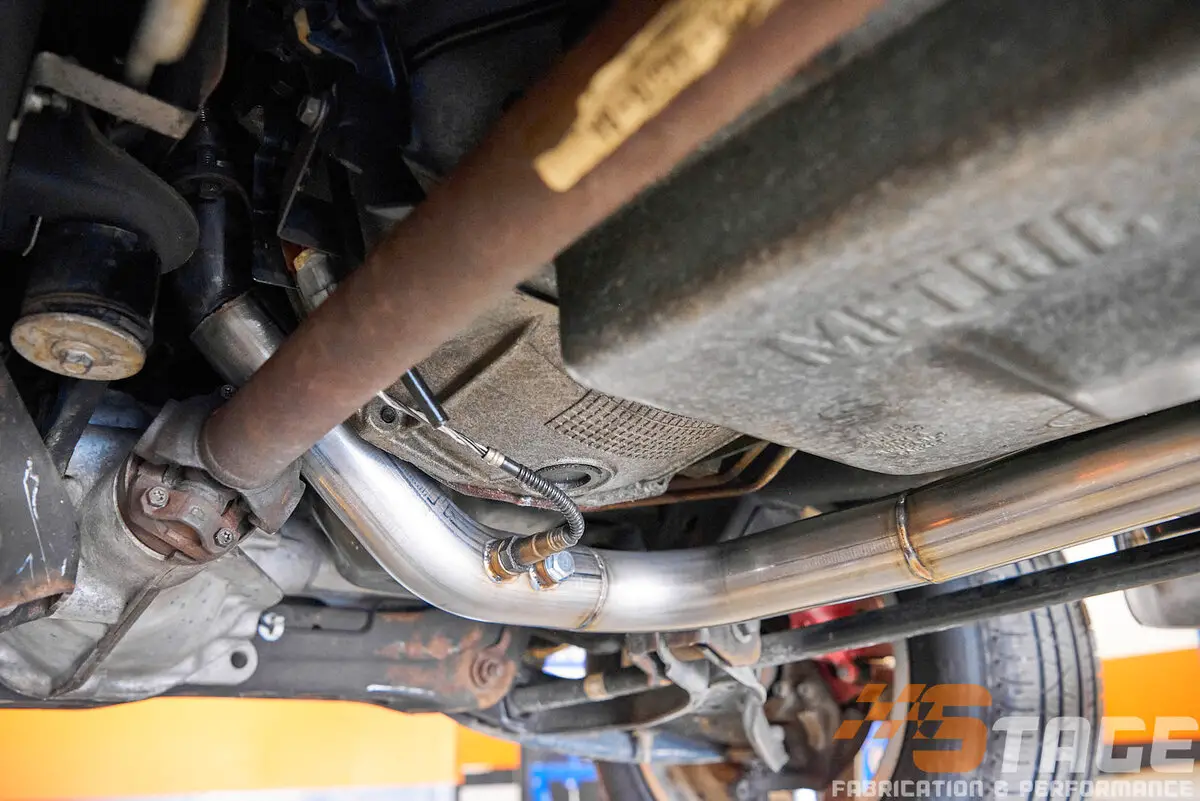

For those who are interested here is the driveshaft clearance with the truck sitting on the ground.

The Borla Mufflers used by Saleen on the Explorer have no path or tube inside between the dual inlets and single outlet. During install of my two systems I saw it was an open chamber inside both mufflers.
That's what I figured, one of the reviews of a new Borla muffler showed a point inside one that had two outlets.
All of the many straight through mufflers seem to look the same inside of them, the Magnaflow etc. I'm interested to know how the Cherry Bomb version sounds given their Vortex model has a center mounted divider in them. The path is split in two and diverted outward towards the sides of the case. I'd expect that to be a hair more restrictive, but with a similar sound to other straight through mufflers.

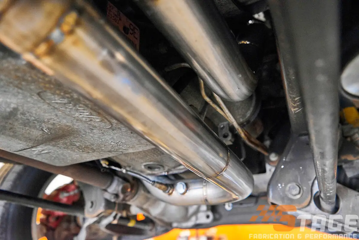

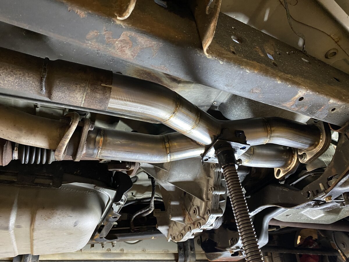

BIG WHITE Ford Explorer is in for latest updates - 1st is a X Pipe for the dual Borla Saleen XP8 exhaust systems that were previously installed.

I like your welder, he's very good. If you could cut up some 2.5" piping straights and bends, you might get him to weld up a pair of cat pipes. What kind of emissions laws do you have there, can you use any universal cats? I've looked and looked at various cats many times. Choosing one is hard, to find one that has great large dimensions, plus has a high flowing catalyst medium.
