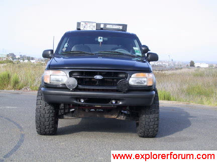

I found this picture of the lights....

Those Pilot lights that you see in the bumper in my pic have lasted me 4 years and cost about $50 ;)
