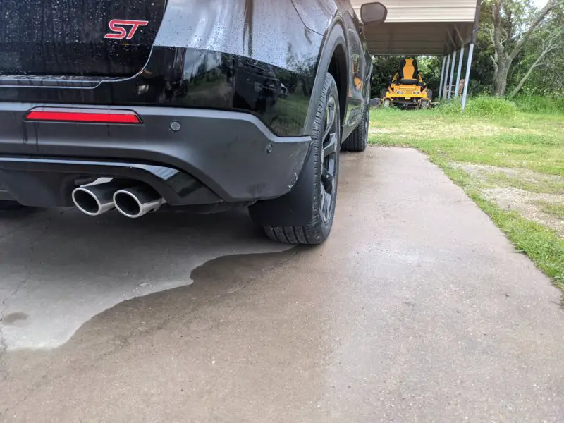

Ordered from Benny at Levittown last week. They came today. It started raining just as I finished the rear install. EZ to do. You will need a 7mm short socket to remove four self tapping hex head screws with flange washers. I hand tightened the top first then installed the bottom inside. Then the middle two. There is a flanged lip that helps secure the splash guard. I like these much better than the Weathertech. They don't look like they came from Pep Boys.
Mike
Mike View attachment 179942
Nice!!!
They are slightly longer too. Much better at stopping overspray than the Weathertech. Not impressed with Weathertechs attachment method either.
