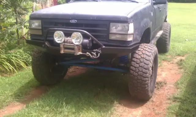

Oh yea the front is welded solid so its never coming off unless I cut it off. lol
awww, you didnt tell me i was getting a new frame too! lol :p
