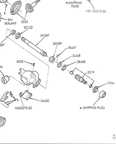

ok to start i have a 98 explorer sport 4.0 sohc about 3 months ago i started having a hum in my front pass side at about 25 to 45mph so i replaced the wheel hub bearings75% of my hum went away but now it is a grinding noise when im driving all the way up to 55 an it scares me to go faster ..even if im doing 15 mph down my street i can here something going around grinding..as of today it is parked.. today i took the front end down to the cv shafts an put some grease in the part were the shaft goes in to the diff....well thats wasent it ......thought it might be a bearing at the end of the shaft but not sure if even one there ....new idea ...drive shaft bearing??? ...were the shaft goes from the transfer case to the diff....now is there a bearing in the end of that were the u joint connects ? im at a loss here i cant find a new diff any were to just replace it or could it be a bearing ?... it kinda sounds like its on the outer part of the diff... i checked the fluid ..no metaly tint to the fluid nor metal shavings ....i have to admit im 25 an this is the first 4wd i have owned (bought explorer 6 months ago) so its all new to me how this works ...im a pretty handy michanic but im not sure if im ready to drop n rebuild a diff......so i guess my question is ..is it possible its a bearing at the end of the diff were the drive shaft comes in to or is there somewere i can just buy a new diff....????...please help!!!!!!!!!!!!..thanks for the time ... daryl:exp:
