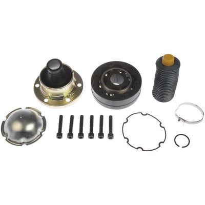

The night mare comes if you want to rebuild the CV joint yourself. 129 at NAPA for it.
I have the instructions from Dorman as they only ones I know of that make the joint.
The front U joint is like all other regular joints. Plenty of You Tube videos on that. Just none on the CV joint.
If you rebuild it your self. Oncwe shaft is out of truck, Pop the rear cover off the shaft. The Cover comes out easy. Once out you will see the shaft and the splined area. There is a C Clip there you got to pry off. I did it with thin flat head screw driver. Once that is off then Release the strap that holds the rubber boot on. Then just pull the whole thing off. Clean every thing good and reinstall everything back from the kit. Remember to put the metal strap on 1st. Then install the rubber boot cap on the bearing. You will have to seat it on there. Its VERY TIGHT. I put a line of RTV on bearing under where the cap will set. Slid back on the shaft and push till the rubber boot is all the way down in the groove around the shaft. Then pull the bearing up back off the shaft. Now take the Grease in the bottle and shot it down the splined hole. Then put back on the shaft. This will force the grease into the ball cage real good. Run a bead of RTV around the back cover. Then Install the back cover making dang sure you line up the holes for the bolts. Then I took 4 sets of Vise Grips and went around edge to seat the cover. That is a true pain.. Cause all that grease is every where. Then pull the strap till no slack in it and bend backwards, Cut off all the excess, then bend the 2 tabs that hold it in place.
