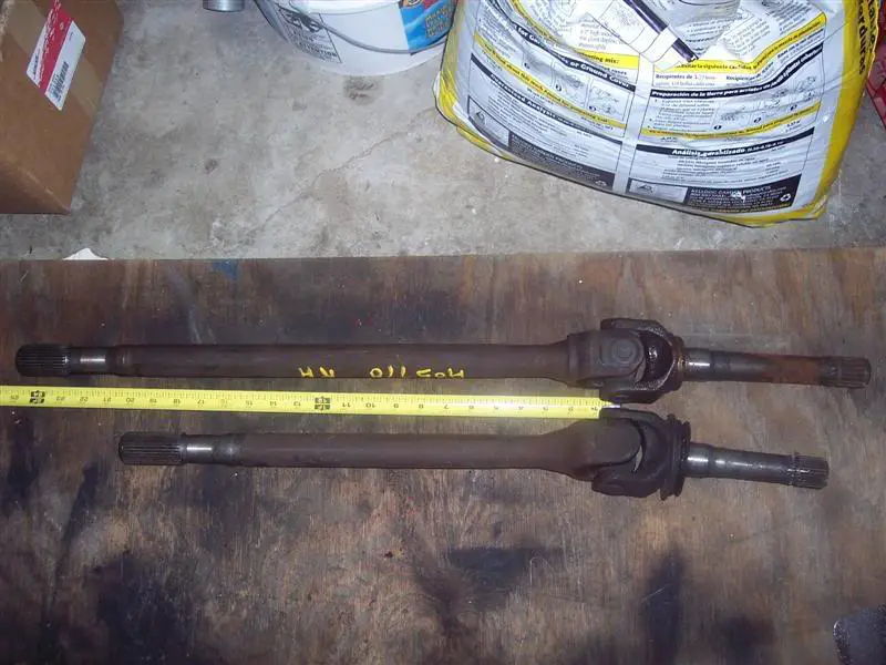

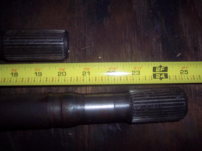

it's 5"s longer than the d35
d35 = 19 7/8"
d44 = 24 7/8"
(measured form the center of the u-joint to the end of the splines)
and i checked it out and it fits right inot the d35 female shaft perfect :thumbsup:

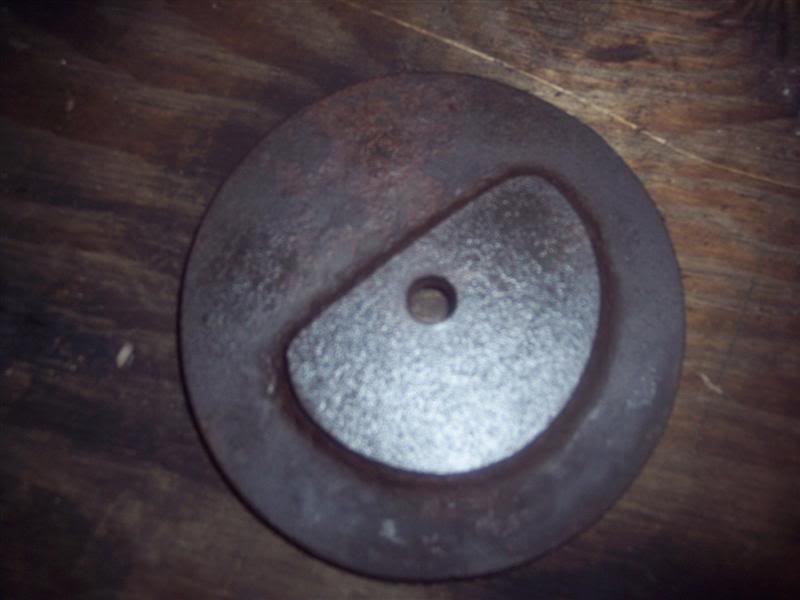

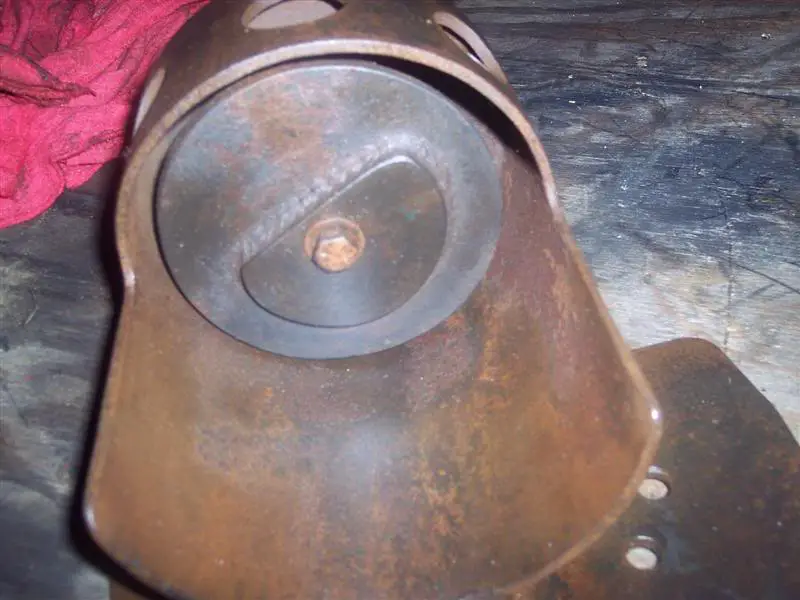

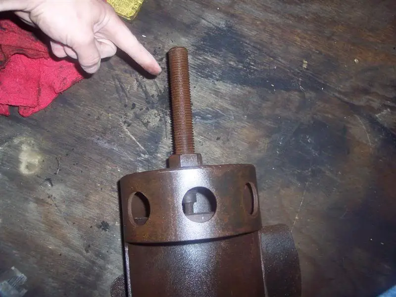

oh and i also messed around with the new coil buckets, tried to get some rust off of them. took em apart too, cause there's the bucket, the plate that the spring sits on, and a big bolt through the top to adjust the ride hight.
the bucket without the spring seat
the thick, movable spring seat peice
all the peices back together
the adjusting bolt
Thanks for pointing that out ;) It's easy to miss otherwise. But wow, that's a lot of adjustment :eek:
keeping the coil in will consist solely on limit straps. i could always weld or bolt something in to keep the spring in, but with the limit straps set right, the coil shouldn't come out.
