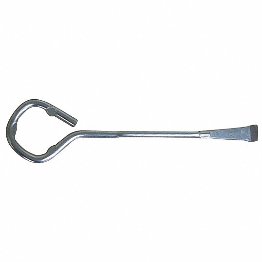

"And the connectors are a real pain to remove because they have clips on both sides. Not squeeze push ins. Ford really screwed us on the design of this engine I tell ya."
A little late but for anyone else and for future reference.... Paint can openers ARE AWESOME FOR REMOVING FORD F. INJECTOR CLIPS....it's like they were made for this and paint cans secondary.....and Home Depot gives them out FREE... Just "start" loosen one side with this then go to other side of clip and it pops right off....perfect little hook to grab clip and lift off without breaking / tweaking anything....

Great idea thanks I have a couple in the garage already.
