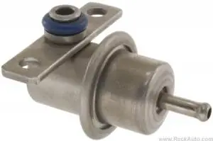

For V6 Explorers/Mountaineers from 1999 thru 2003 with the returnless fuel system (fuel pressure regulator mounted in fuel tank) a fuel pressure damper is mounted on the fuel rail.
This is what I have on my fuel rail. Passenger side towards the front of the engine on the end of the fuel rail. I think some late model '98's had returnelss added. Which makes it super confusing but I think I have returnless and if thats the case 30psi at idle is no bueno.
Has a rubber diaphragm in it acted upon by vacuum. Flow is thus controlled to maintain desired PRESSURE. A diaphragm LEAK will bleed fuel into the engine, wasting it, and causing rich mixture. The diaphragm may be tested using one's HEAD: draw a stiff vacuum with mouth & tongue then maintaining it, place tip of tongue over opening in tube, thus holding in the vacuum. If it bleeds away, diaphragm is leaking.

Yeah easy right? Try getting to that thing without taking the upper manifold off. LOL I was able to get a hose in there barely with my fat fingers and hooked a vacuum gauge to it and it held all day. So I can rule that out.
