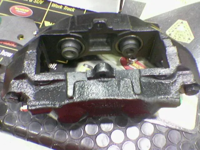

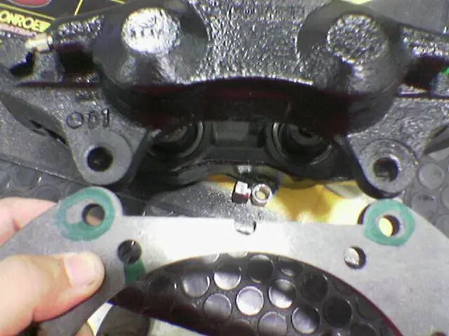

ok, nix' ing the rear steer, looks like some vette calipers will be on the truck, and workin on the rear gas tank so i can get that m37 case in there

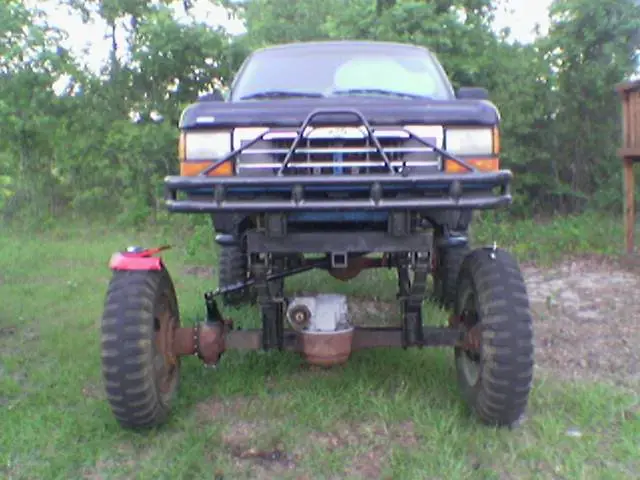

the damn bumper just commited suicide and couldnt take it anymore :) , anyone recognise the new bumper ? :) , it looks like the truck is smiling at me now, gotta work on the brackets to bring it back down, gotta trim here and there cause of that damn crossmember
oh yeah, stock bumper and grill push bumper are for sale, just make me a reasonable offer and shameless plug reminder that i have the brand new 31" spare tire for sale also
heh, too lazy to take that little chunk off, plus its an old throwback to your truck :) , jk around

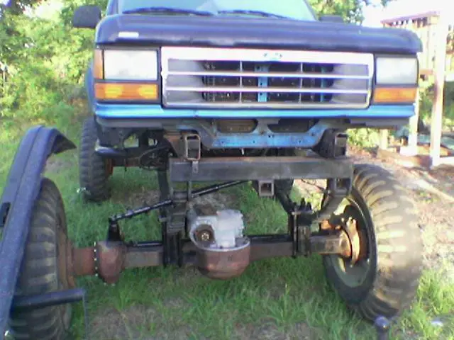

Why does that front axle not look centered to me?
i was going to ask the same thing.
EDIT: nm, he says he has the pass side wheel on backwards.
Oh, I thought something didn't look right!
the reason it is on backwards come to find out is that the offset of that dually wheel is 10 inches, and with that steering arm i need to be 8 or less, gotta remember, these axles were never meant to have a crossover steering arm like that
what about a hydro steering would that make it better???
just make it so i could do one finger turning and prolly take a little strss off the steering box
Or a drag link angle that steep!
