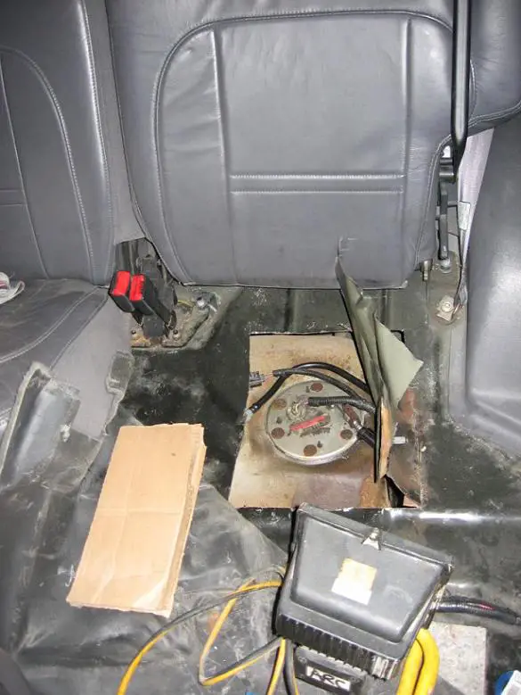

tank fuel line
I turned the ignition on for 1 second and then shut it off and checked for drips. The fuel is running down the front of the fuel tank so I probably need to replace the fuel line from the tank to the filter. The photo below by johnny23toronto shows the top of the fuel tank.
