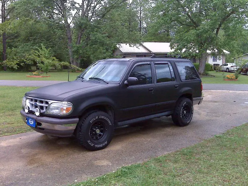

$70 bedliner. No issues with scratches, waxing, or lack of attention.
i want to use that stuff on my rockers!
tired of gravel chips.
I'll tell ya, I have rock chips on my sides, all the way up the doors. It always tempts me to Herc the sides and be done with it.
I think black on the roof would be too hot for my climate or maybe my tastes. You're in Florida so you probably know what I'm talking about though.
whats up with this paint job??????.....($70 bedliner)
