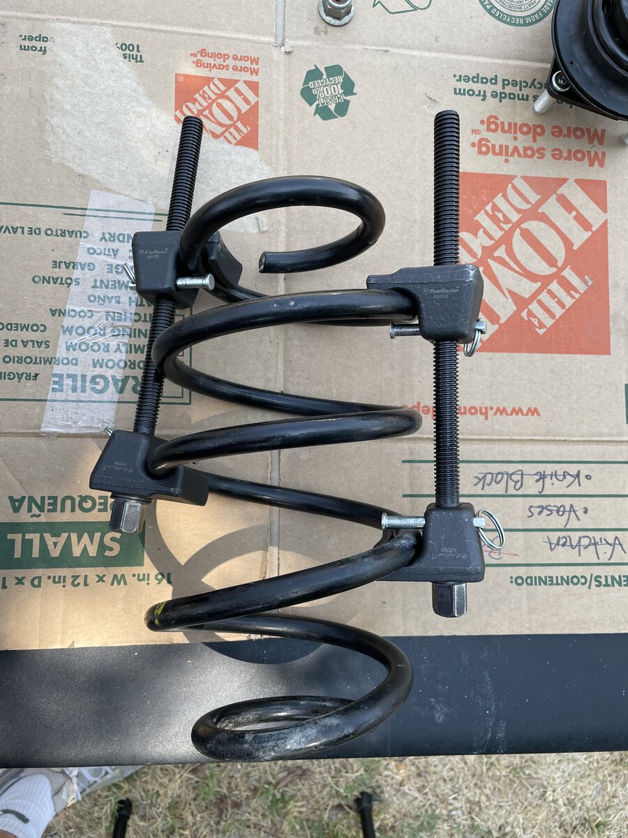

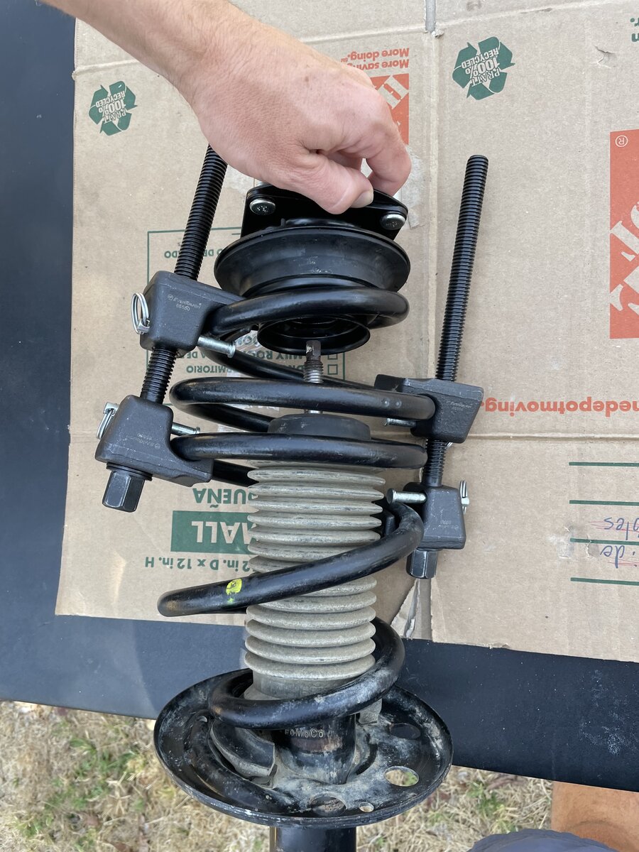

Update: I tried again today and failed. Car’s sitting in my friend’s driveway so after about an hour of trying this way and that way I gave up, removed the other strut assembly and brought it to a shop that’ll probably charge me an hour’s labor to properly install the new strut mounts.
Mechanic at the shop told me it’s a pain to compress these kinds springs with the basic tool but he was prob just being nice. Uploading photos of a few attempts. You can see the springs are compressed about as far as they’ll go and still I need about a couple inches more to bolt on the strut mounts. There’s gotta be a way but I sure didn’t find it.

It looks like you need to expand your clamping distance. Additionally you want to apply equal clamping force. You have one clamp higher than the other and that is not going to work well. In theory, the spring will compress easier the farther apart the clamps are from each other.
Maybe the spring is just too tall, but I wonder if this could have been accomplished if you had TWO sets of those to continue compressing after you got the coils closer together so the reach on the 2nd set could add one more loop of it.

I also could not compress the spring enough to install new Strut with OEM TOOLS IN PICTURE. Takin old off no problem but had to compress ALOT. Stopped by local mechanic with new struts old springs and new mounts and for $100.00 I was back in business.
Should have not bothered to even try to dissemble and reassemble. I have used this tool on a few Hondas without issue these Ford Springs are too big I guess.
My recommendation don't bother just take the old assembled strut out and bring the parts to mechanic to remove and assemble the new strut or go with quick strut. I wanted the stock ride so I didn't go with quick struts but yes that is an easier option as well.

I still think the potential solution is to use two sets (3x or 4x pieces) of spring compressors.
Get the compressors as far apart as you can in the spring to start, meaning you have to get them on the bottom or top coil as much as possible, a bigger spread.
Then put them 180 away from each other and see if you can get the length you need for the shock to go in
